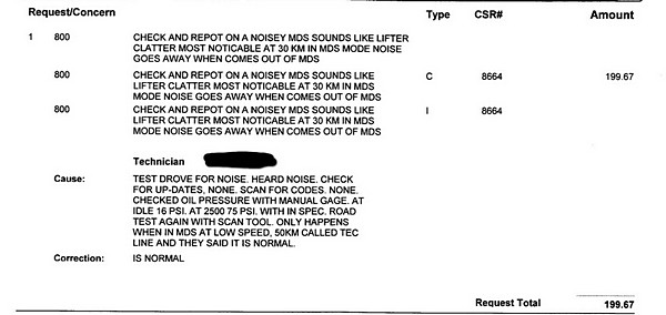

Originally Posted by Dusty48
Keith, is this an actual quote in writing?
Attached a slice of the work order:
Some months ago I ran into a couple of CDJR techs. at a dinner and discussed this issue with them. In my case after replacing the MDS lifters, solenoids, and one cylinder head, the issue came back within a few thousand miles. One tech. stated quite emphatically that he had addressed several of these MDS noises and in all cases replacing the timing chain and chain tensioner guides resolved the problem. I did verify that there was a tensioner problem identified in 5.7 car motors, but was also told they use a silent chain tensioner as opposed to the truck motors.
I’m not convinced that the timing chain/tensioner is the issue in my case. Perhaps there’s another issue at play here for others suffering like maladies. Without a better explanation of the physics at work, or why/how replacing the timing chain and tensioner resolves a clattering MDS system, I’m not on board with that as a solution. My noisy MDS does not only occur when coasting but clatters under light throttle load up until I can’t hear it anymore due to vehicle speed and air turbulence. The coast down clacking is oh so reminiscent of a collapsed lifter on an old LA series or GM small block V8. Under load and accelerating with MDS active, there is more clatter than clacking and I’ll admit it akin to timing chain slap but then that should not be occurring under those operating conditions, even with a worn out chain.
