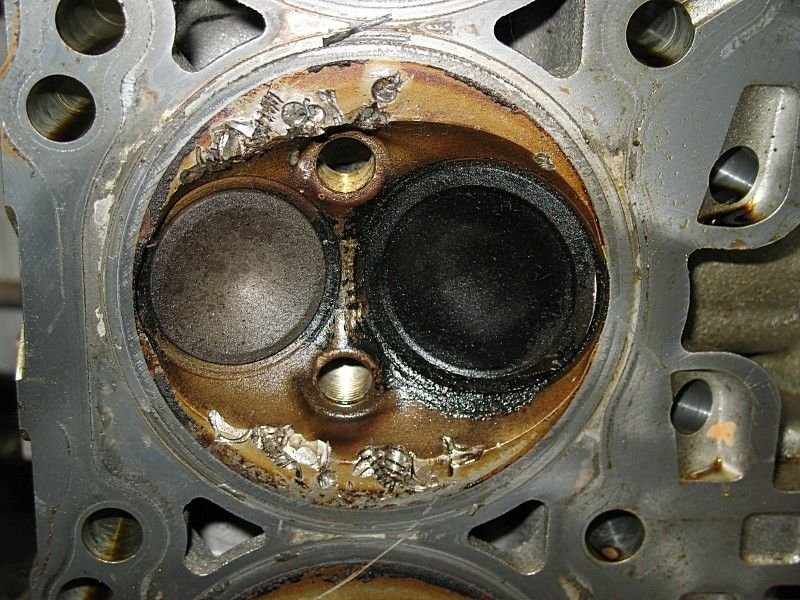

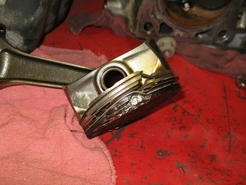

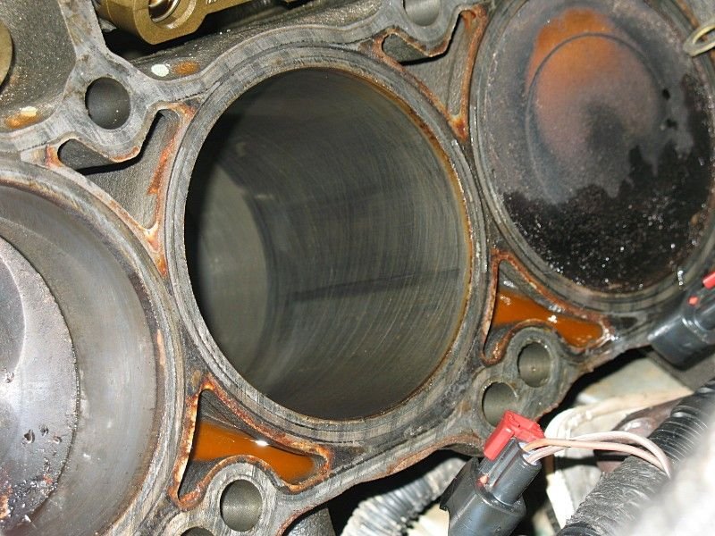

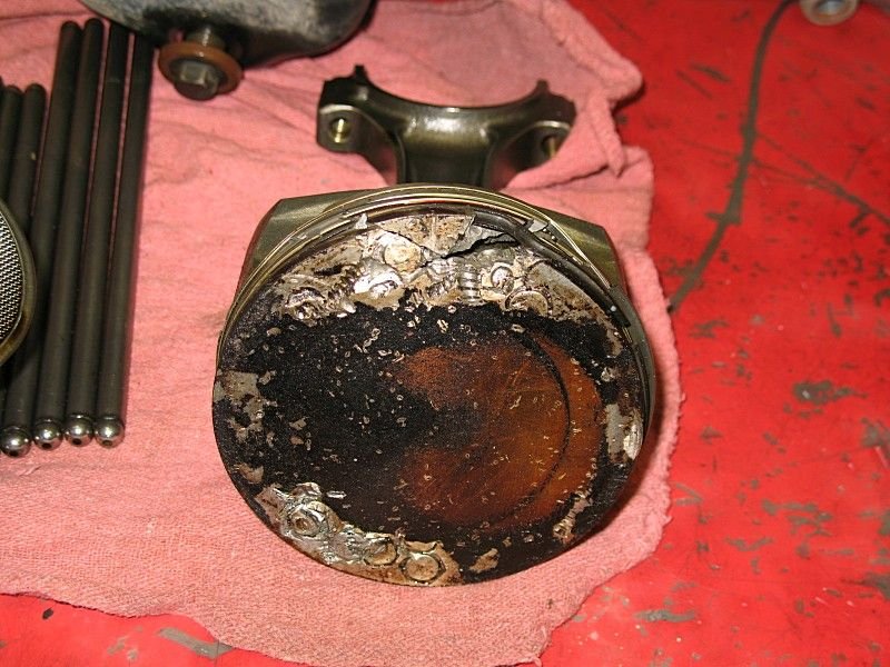

Late to the party but wth...
This Hemi has the MDS tick subsequent to the damage (2012) depicted. It's not a timing chain issue! Chrysler (FCA) flipped me off just prior to the power train warranty expiration because... "It's normal." Horse puckies, it's normal.

Good pictures. Based on the imbedded marks (possibly from a screw or bolt or a piston fragment) it looks to me that something got into the combustion chamber causing the damage. So I'm not sure this was even related to the MDS noise, much less proving or disproving a loose timing chain theory.
How many miles were on this motor?
55K km. Damage was caused by a screw with 10mm head - similar to the one used to fasten the TB to the manifold. Theory (dealer's) was that the screw was somehow left in the intake manifold during manufacture. The screw had been in there for some time - the inner walls of the plenum were scored up bad. The engine was purring like a kitten when I approached the dealer about an oil leak on the intake near the PCV valve housing. Shortly thereafter, the internal damage was discovered. MDS ticking began shortly after this repair. It took me over a year to get somebody at the dealer to acknowledge that. They agreed that it was not right. Chrysler engineering disagreed.
