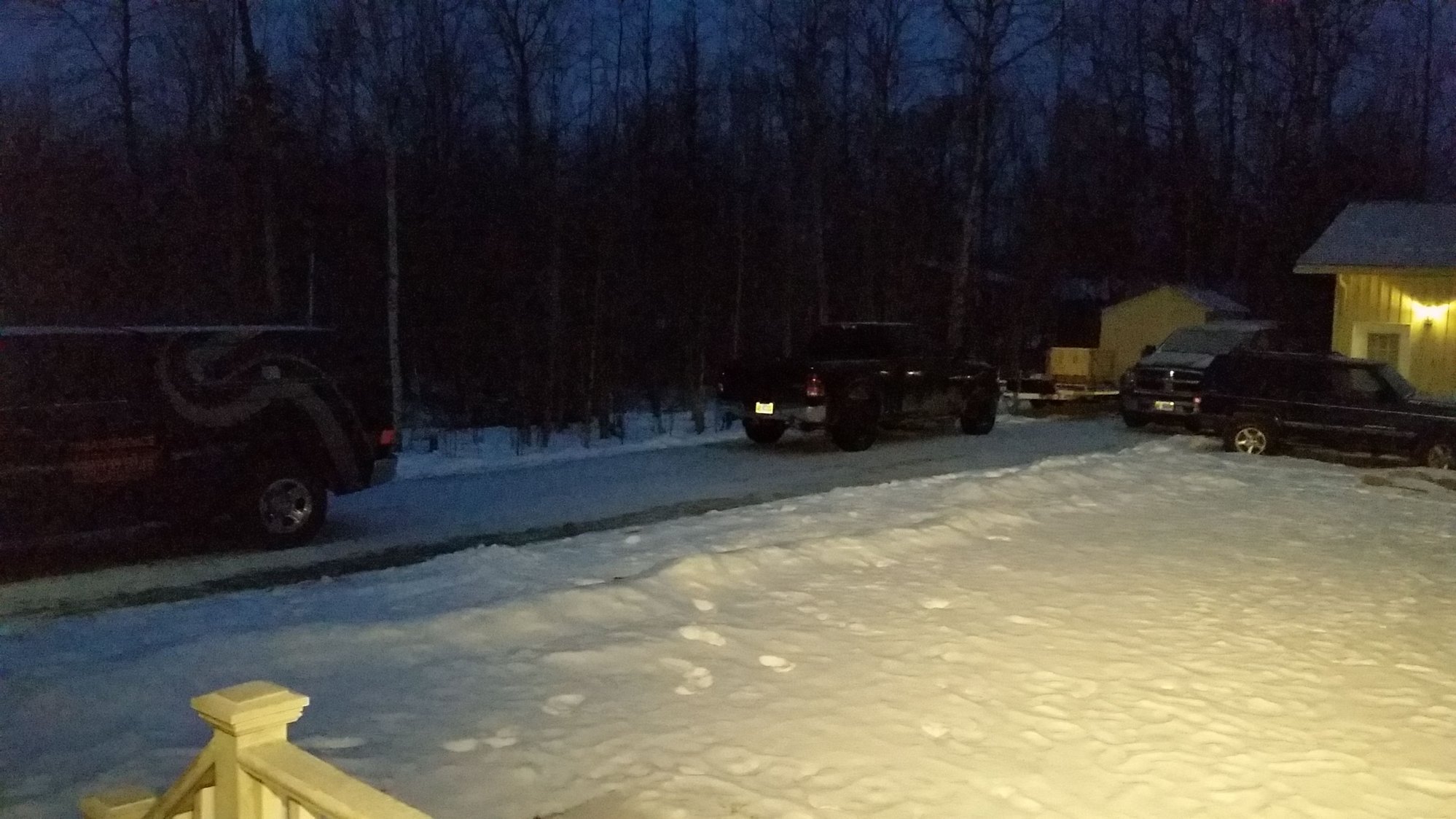

Haha I wish it was that easy. My other truck is trapped behind this one, blocking the garage, and my winter beater car feels like its about to blow a wheel bearing... total crapshoot. Lol.

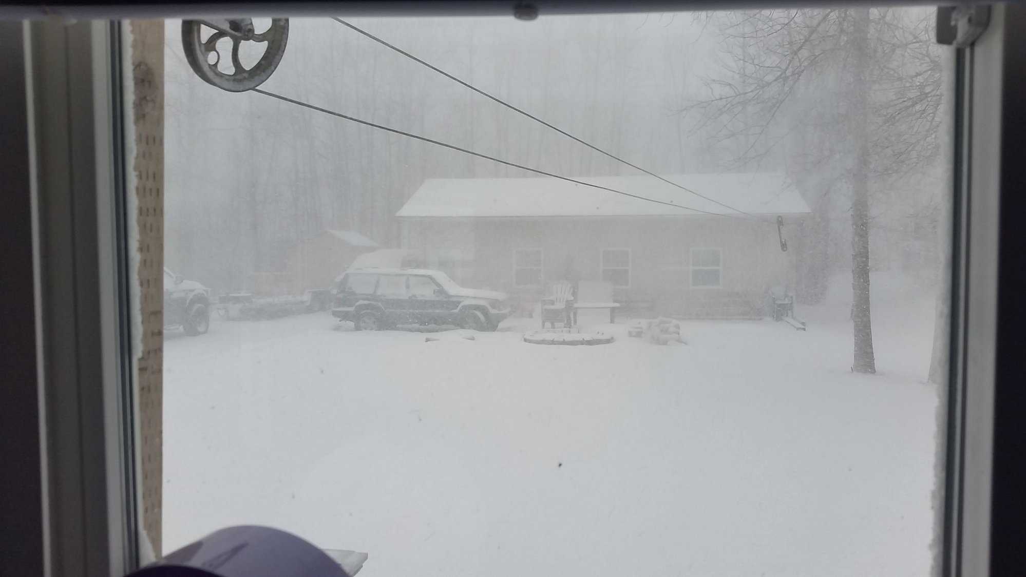

Yeah, that looks like REALLY good weather to STAY IN THE HOUSE!
Got 4 wheel drive? Then you ain't trapped, just go around. I was absolutely amazed at how much snow my 96 2500 would thru with A/T tires, and open diffs. I went to pick up a snowblower for my tractor, but, the blower is in the guys back 40, and there was 2 plus feet of snow on the ground. My truck drove back there like it was open ground. Didn't even think about getting stuck. I was impressed.
Besides, playin' outside in that is just not a good idea...... (unless you are getting paid REALLY well for it.......)
