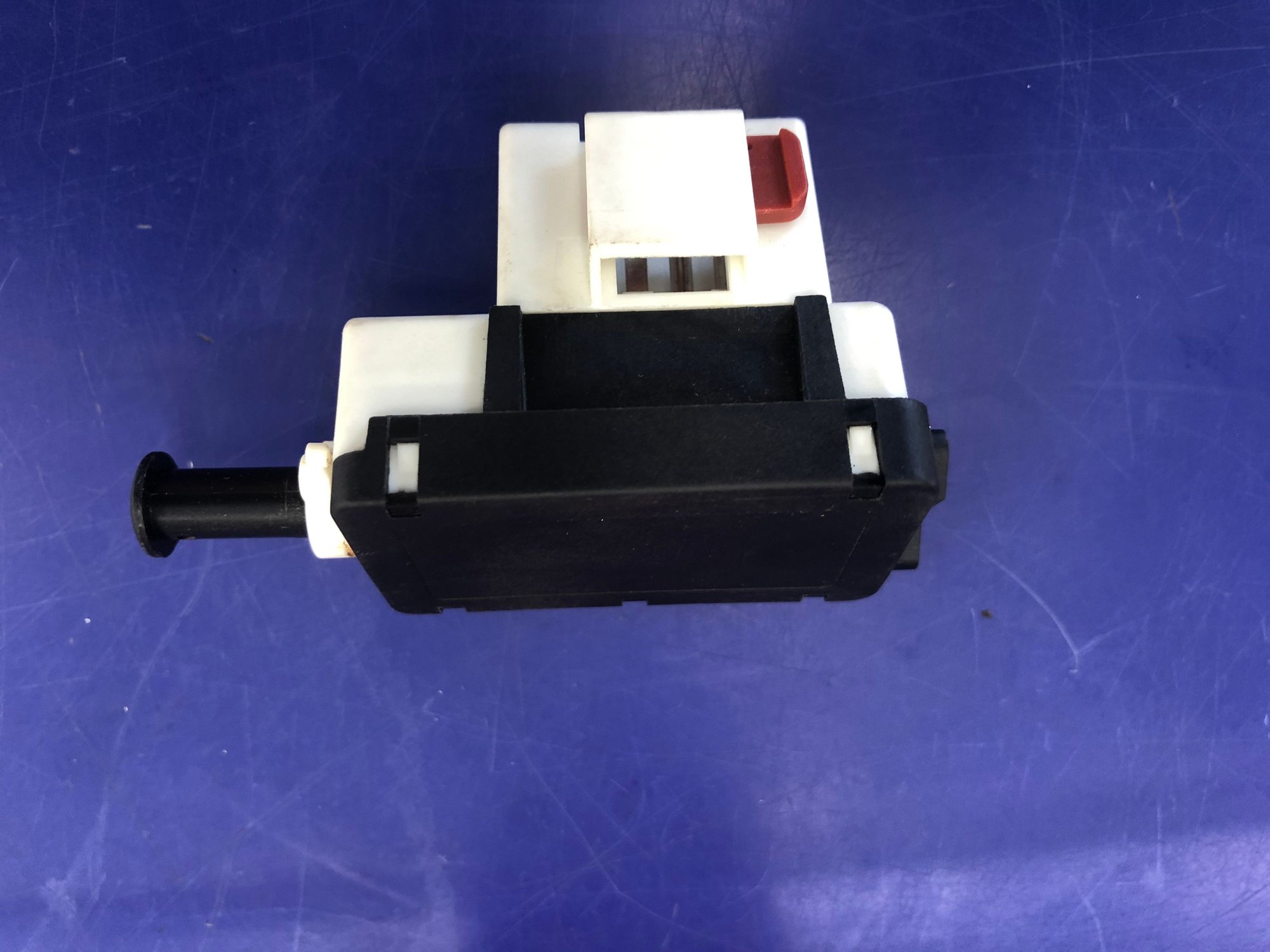

Changed servo with know working unit
changed brake switch
checked all vaccum lines
Checked all the wiring harness as I have a code 1595 (Speed control vacuum or vent solenoid control circuits shorted or lost)
relay swapped
I do not think it is the clock spring as everything else is working but will try swapping clock springs with a used one I have that is in working condition.
Anyone with any thoughts? All are apreciated.

UPDATE: Well it is not the clockspring but I knew it wasn't. Cleaned every connection in the vehicle and in the engine compartment. Only thing left is a short or break in the wiring harness, the PCM, or control switches on the wheel.
One thing I never noticed before. When I have the brake pedal pressed and activate the cruise control, the light stays on and I can switch it on and off. Once I release the pedal the system fails and will not reactivate unless the key is turned off and then back on.
This thing is driving me nuts.
