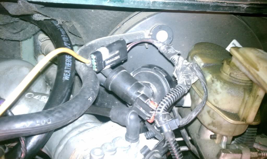

Ok guys, so I'm a car nut, working on my father-in-laws 96 caravan, I can't find where one connector goes to.
I believe it's a connector from the egr solenoid valve but need help.
96 Dodge Caravan, 3.3L V6
see pics below

if your not sure where it connects to, can someone snap a picture of thiers under the hood.. 96-99 caravan 3.3l
It's behind the throttle, under the washer arms and parts compartment

That looks like the TPS connector.

i believe the tps is connected.. there is a connector on the side of the throttle body, connected already.. I know there is a tps and another throttle connector.. any other ideas anyone

There are connectors for the throttle body. one is TPS and the other is the AIS ( automatic idle speed) motor. The EGR already has a connector plugged into it. The only others are the speed control servo or the MAP sensor.

thank you very much.. it was the tps connector, the connector was hidden where it wasn't visible..
