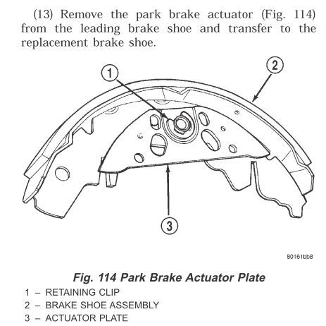

Leading Brake Shoe. I removed both brake shoes as instructed by the service manual but the final step it states:

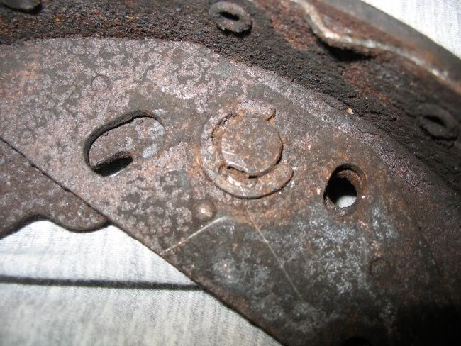

The diagram shows a retaining clip is holding the actuator plate on the old leading brake shoe. Here is a photo of my old brake shoe:
I'm assuming the retaining clip is the semi-circle flatter clip. I have no clue on how to remove this retaining clip. Does it rotate around the center axis, yank off, or what? I tried sliding it and prying it but it is a rock refusing to budge. I accidentally chipped the center piece trying to pry the clip off.

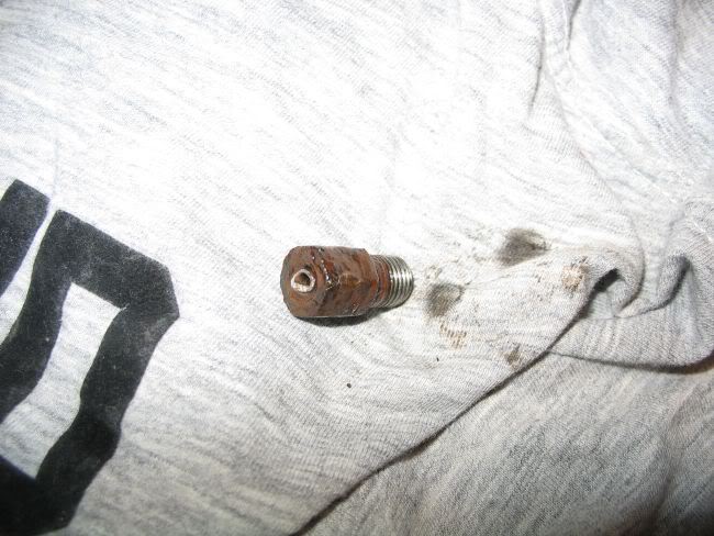

Wheel Cylinder. I am also replacing the wheel cylinder. The manual stated i should disconnect the rear brake hydraulic tube from the wheel cylinder. I did this by unscrewing it. It eventually came off but i notice a piece of the tubing is still inside:
To me this seems like the existing hydraulic tubing wont be able to fit back into this screw. What do i do to resolve this?
