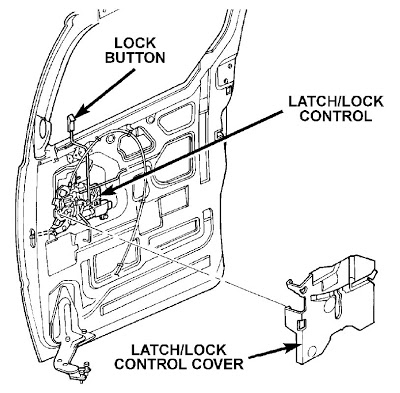

I'll re-post this here (why two post for the same thing???)
The only instructions I found was:
- Install latch / lock cover.
With the following illustration:
George

I had the same picture but couldn't get it to work right.
George
why george!?!? because the DRIVERS SIDE (drivers left) is different!!!
you are getting warmer!! yer climbing up on to that top box on the podium!!!! almost there!!!

drivers side is a mirror image. Think we'll leave the rest of the leg work to you.
i am encouraged that someone thinks a part could be a mirror image, i mean why would GM/dodge make something so simple?!?!
from the illustration one can see "which way is up", which is a BIG clue. i think the monkey with the spanner can take it from here. heh.
