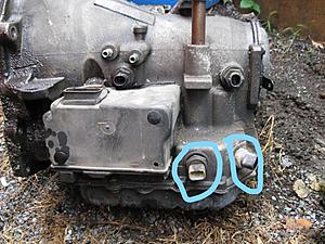

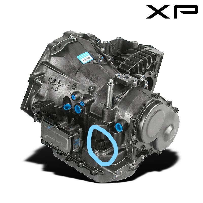

the transmission wont work with the wiring in 1998 the range sensor was built onto the valve body in 1994 it was a sensor that screwed into the front of the case next to the solenoid pack the picture is what you 1998 should have

I don't know if it can be wired they are 2 different transmissions the first picture is what your 1994 should have and the second 0ne is what your 1998 should have you would also have to figure out if you can take 2 switches and make it one sensor and the tcm and pcm would probably be different also

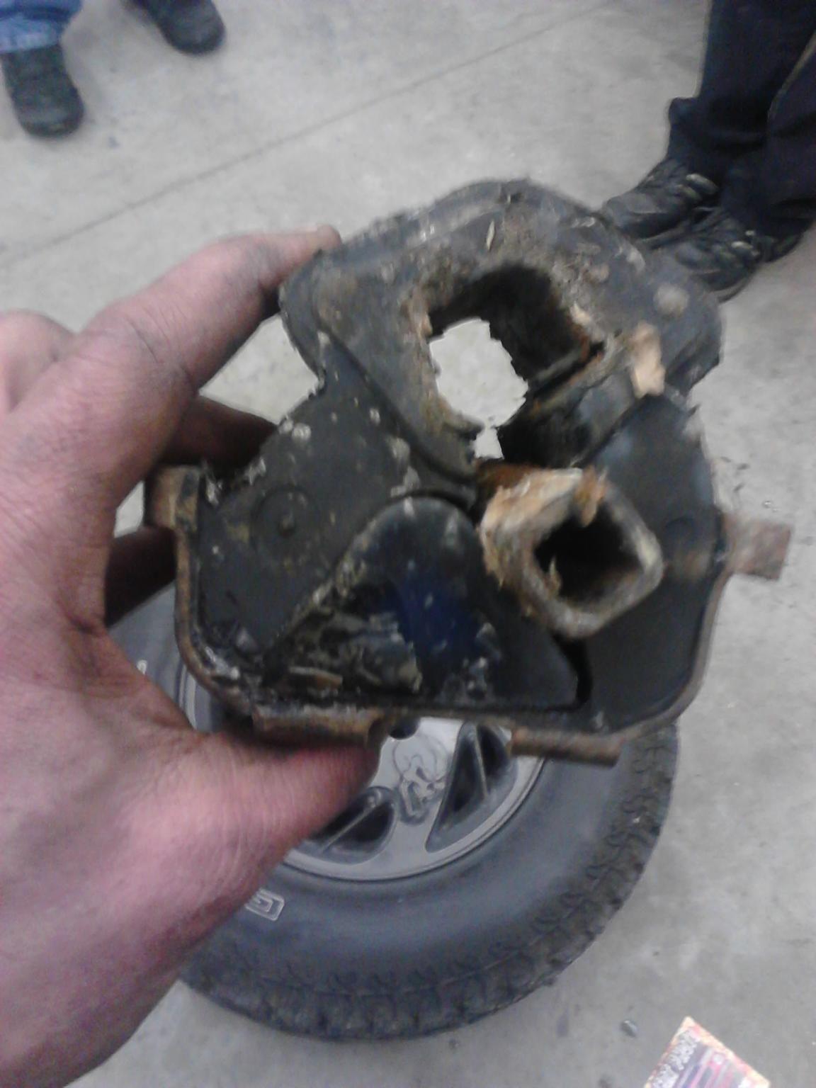

Tore into her this weekend. Was pleased to see the diff was in great shape.
Started checking other things, and found the issue:
Mount was tore apart so bad it had allowed the trans to settle enough to make the DS axle seal leak (hence where my fluid was coming from). The Clunking I would get under acceleration was the trans bouncing up and down with the torque.
New mount installed and problems solved!

I was relieved when I found it was just a mount that tore up. I was expecting much, much worse given the symptoms.
