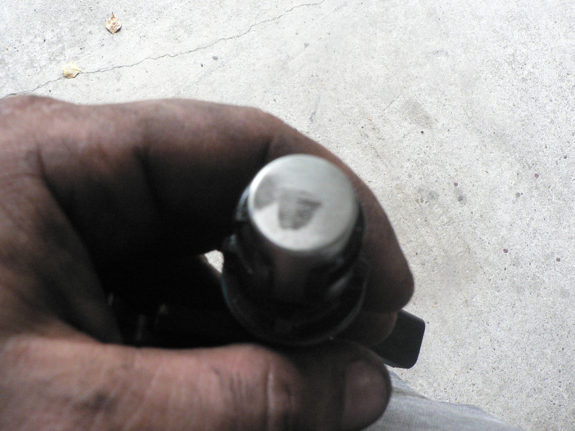

The knocking sound can be from cam sensor possibly, because when I put this sensor to whole, there was a contact with cam gear on the begining and the sensor(I dont know how to say that-was wiping or was scraping, rubing)cam gear. I have a new video with two sensors together. Maybe this will help. I am not a specialist, but I think that problem is with reading by cam sensor-you can see it on a screenshot

Problem with knocking is I think is here
