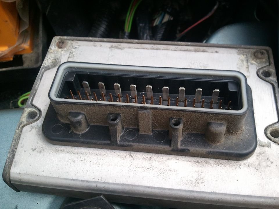

Check contacts between FCM and IPM
FCM
IPM

Couple of Ideals. Did you remove the connector a check to see if you had power and ground? And are the washer bottle full? If you don't have power and ground I would start looking at fuses and maybe the multi- function switch.
