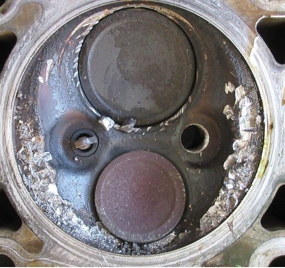

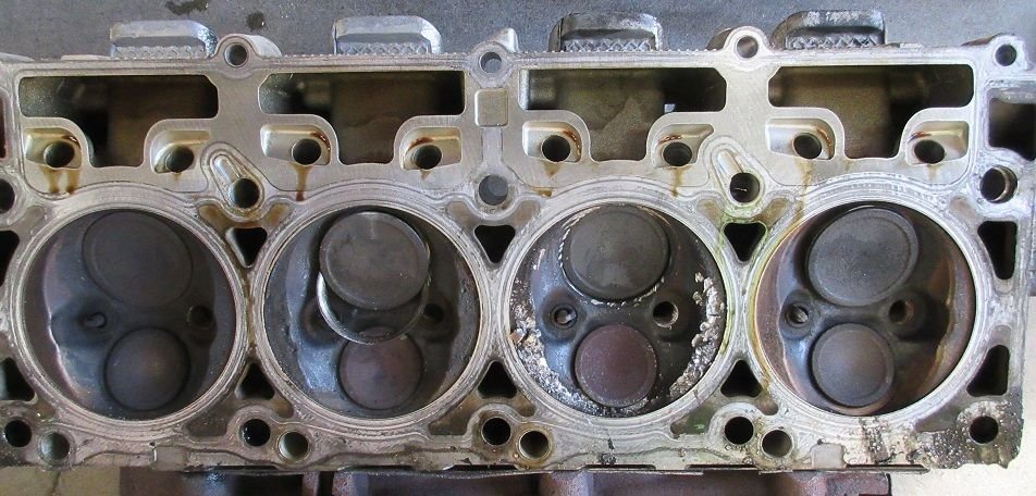

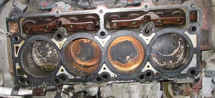

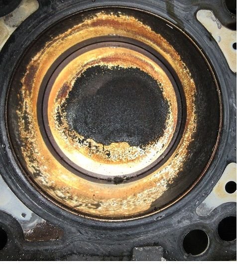

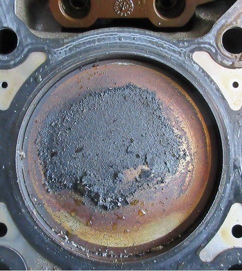

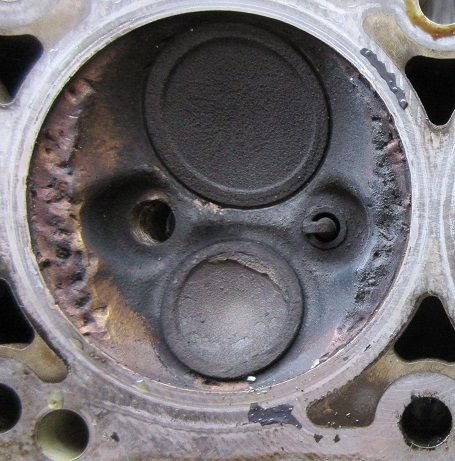

Pics? OK - I'll start with the cylinder damage..
Left bank
left head
Cylinder 1
Cylinder 3
Cylinder head 3
Cylinder 5
Cylinder head 5
Cylinder 7

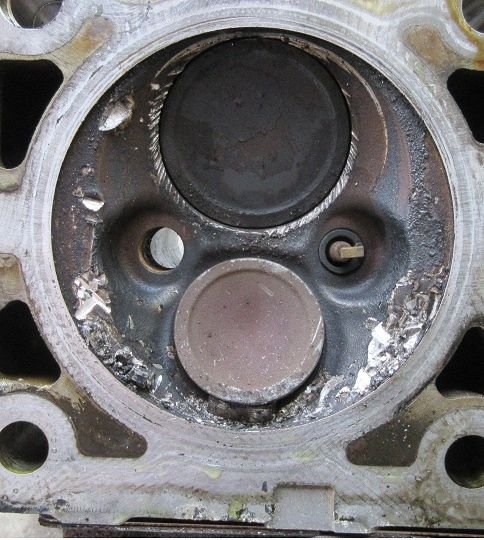

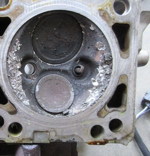

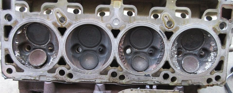

Right bank
right head
Cylinder 2
Cylinder head 2
Cylinder 4
Cylinder 6
Cylinder head 6 (prior repair)
Cylinder 8
Cylinder head 8
Old Nov 11, 2020 | 05:36 PM
Posts: 87,468
Likes: 4,220
Wow..... Did that sit for a while? Or is the rust from some other cause? (cracked block??)
Gonna try and save the heads??
Old Nov 11, 2020 | 06:57 PM
bcuda's Avatar
bcuda
Joined: Feb 2017
Posts: 34
Not rust - just lighting and discoloration.
Not gonna chance having an issue with the heads - but they were good enough for a core credit on a set of "corrected" heads.
Old Nov 11, 2020 | 09:08 PM
Posts: 87,468
Likes: 4,220
That's some weird lighting affects.
Good plan.

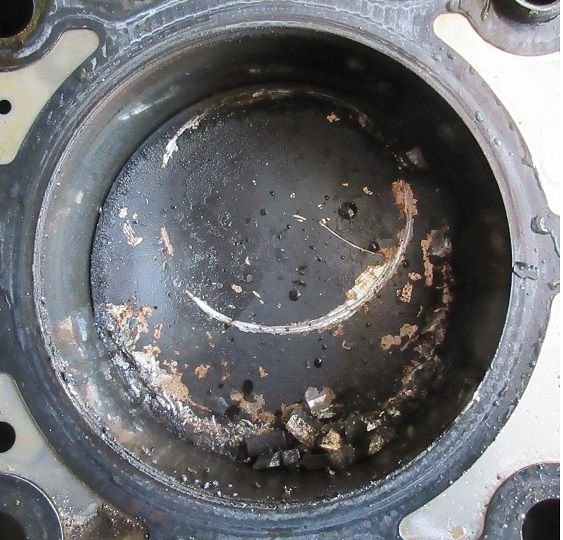

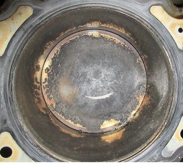

As you may be able to see, there is some scoring on some of the cylinder walls.

Old Nov 12, 2020 | 10:17 AM
Posts: 87,468
Likes: 4,220
How could they have missed that? The damage is friggin' obvious......
