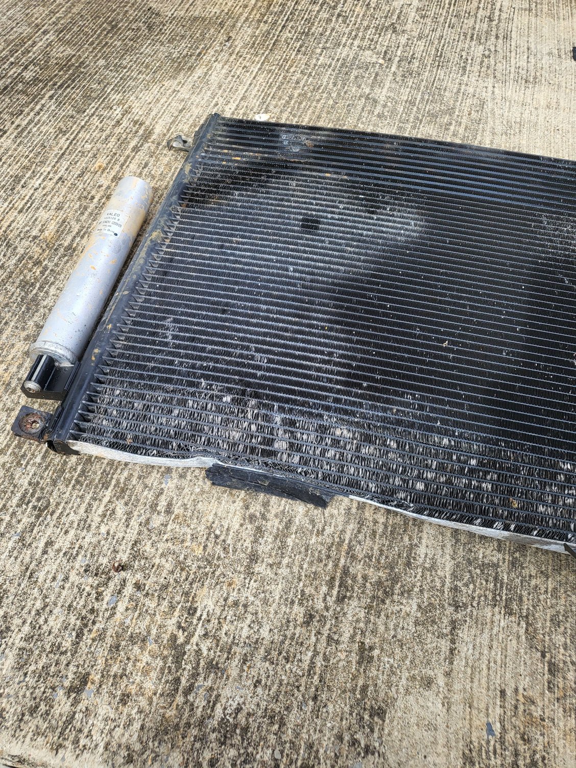

I got up friday morning and looked into it, and it was the radiator this time. Recall I hit a dead deer a few months ago, and bent the radiator. I said I was going to drive it until it exploded.. Well, I guess it exploded thursday. Thank the Lord I bought a radiator. My immediate plan was to replace the radiator, and leave the tweaked A/C condensor in place, because I havent had a chance to have the system evacuated. But when I was removing it, the bolt next to the dryer was rusted in. I put some blaster on it, and tried it again, but it split the condensor right at the welds for the dryer. Well, I guess Im changing the condensor also, I thought.

Condensor/trans cooler/dryer. You cant really see how bad this is, but its folded over almost 2" at that bottom portion

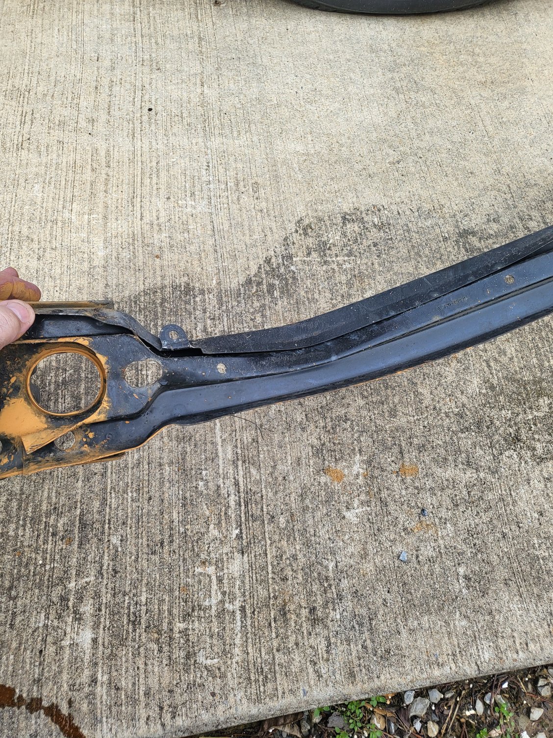

Radiator support. This thing was mangled. It was bent and folded.

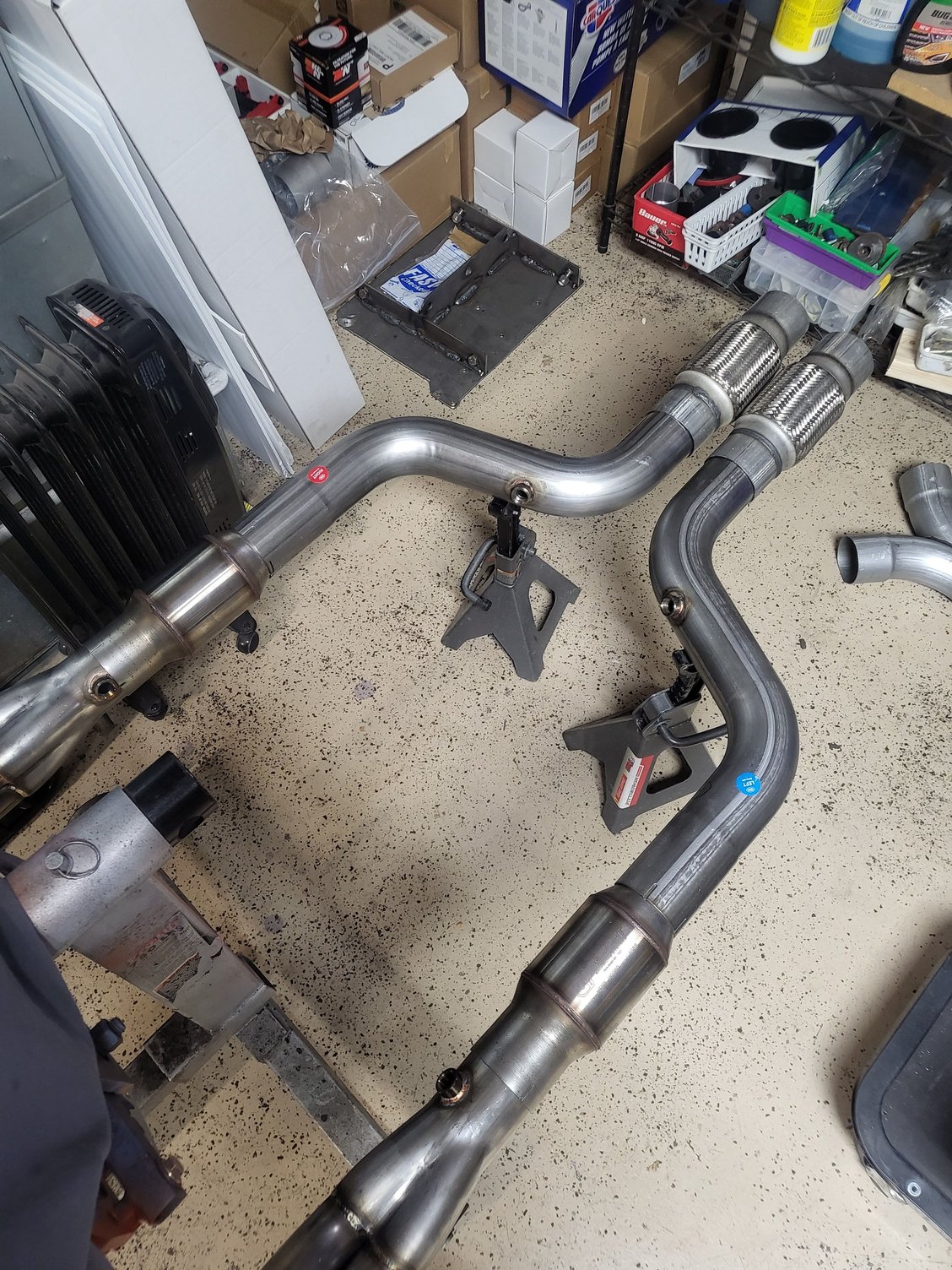

So I have started looking at the exhaust install. I noticed the shape of my X-pipe isnt going to work, so I have 2 options. 1) run an H-pipe instead (I could make this very easily--see pictures). 2) modify the x-pipe. Im not sure which one I will do to be honest. But I have another issue. I bought the stainless headers/mid pipes/ cats kit from modern muscle. I have to add an O2 bung for the gauges I am adding, and to help with tuning the HPtuners. I have the gauge and it uses a Bosch 17025 O2 sensor. I dont know where to put it though. The exhaust already has the 4- O2 sensor bungs, so I dont want to get too close to them. Plus I have a tig welder, but I suck at tig and I have never welded stainless. I want to put it back further in the exhaust, because after the mid pipes, I have a steel exhaust and a mig welder. If I run the X-pipe, it could go in it. Some people say not to do that, some say its okay. But with an H-pipe, I cant put it in that. The instructions say at least 18 inches from the collector, but Im going to be closer to 30+, which it says would be fine for a turbo car.
What have you all done with your O2 sensors?
X-pipe. I can straighten the ends, but it would be a lot of work. An h-pipe would be easier, and very short.
I think this is how I will run it. All the parts forward of the flex pipes are stainless. The flex pipes and everything after will be steel. I would add the h-pipe right after this.

Put your wideband where the red or blue dots are.

The instructions say a minimum of 18" from the collector, so that would be too close. The lower bungs (the second set) you see there are close to that measurement. Plus those are stainless, and I would have to get someone else to weld them. I can do that if I need to, but before I do that I need to see if thats a good location on the car also. I cant seem to find any really good pictures of these cars from underneath.

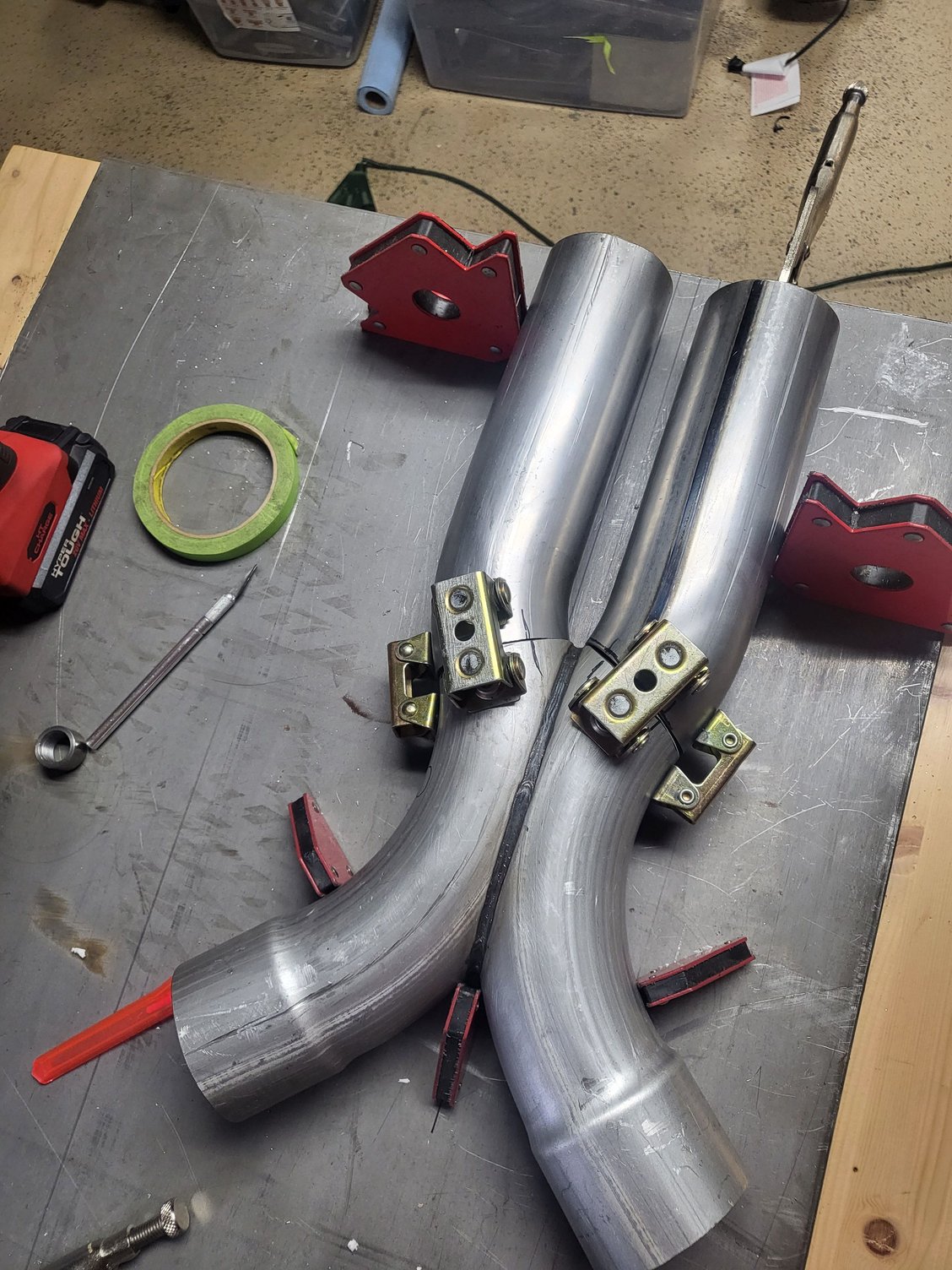

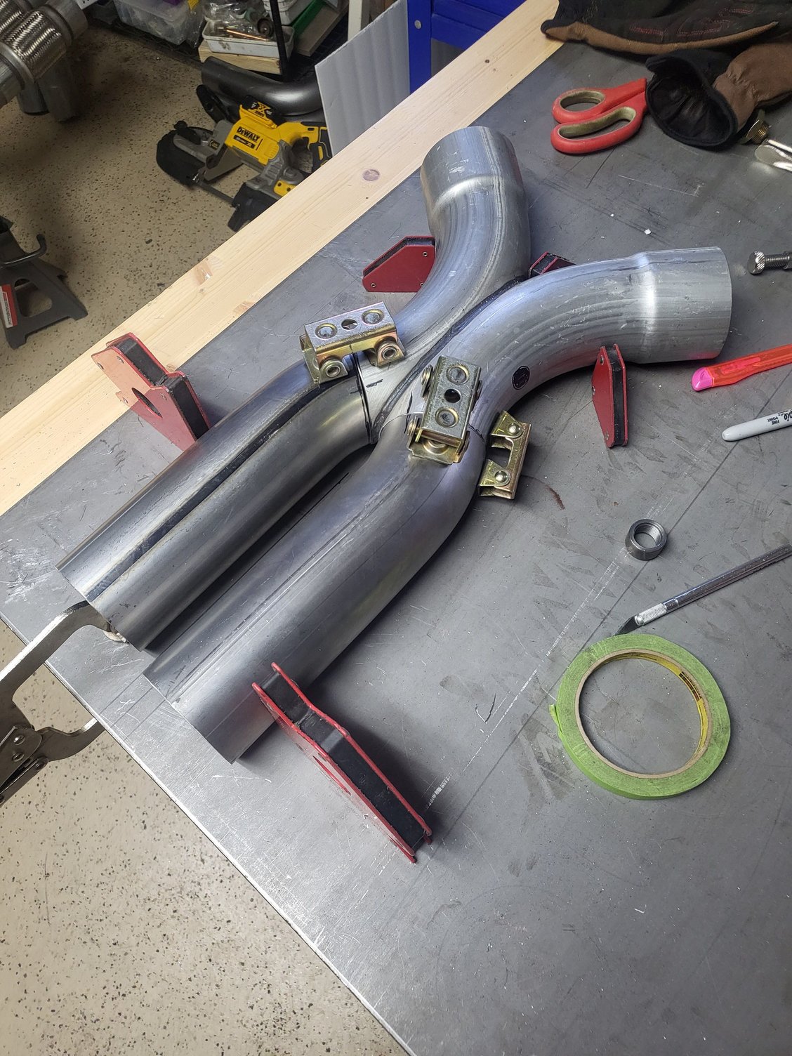

So messing around in the garage today for an hour or two, I came up with a plan. Dont judge the gaps yet, I know they are gross, but my wife babysits and I couldnt make a ton of noise, so Ill clean this up before welding. The pipes needed to be an inch apart at the end to fit the way I want them to fit, and this gets it done. I will also just put the O2 sensor in this area (shaded circle) and go with it. Of course I have to double check the angle on that as well, and Ill make sure there is nothing in the way under the car.
Im not sure what I need on the back side, so I havent looked at it yet. I might just tack this really good, and wait. I think Ill have to do the same thing, but I need to be under the car to see this first. I dont have a lift, so Im going to be doing this the hard way; jacking the car up and rolling in and out with a creeper. Although I have been trying to talk the wife into one of those mini-portable lifts. 24" of lift, and it runs off of 110 VAC. That might help me a little.
Its not lined up very good either, and the gaps are bad, but Ill deal with that. This is the basic idea.
The shaded area is where the O2 sensor will go. Also the ends are not the same length, Ill fix that too.
