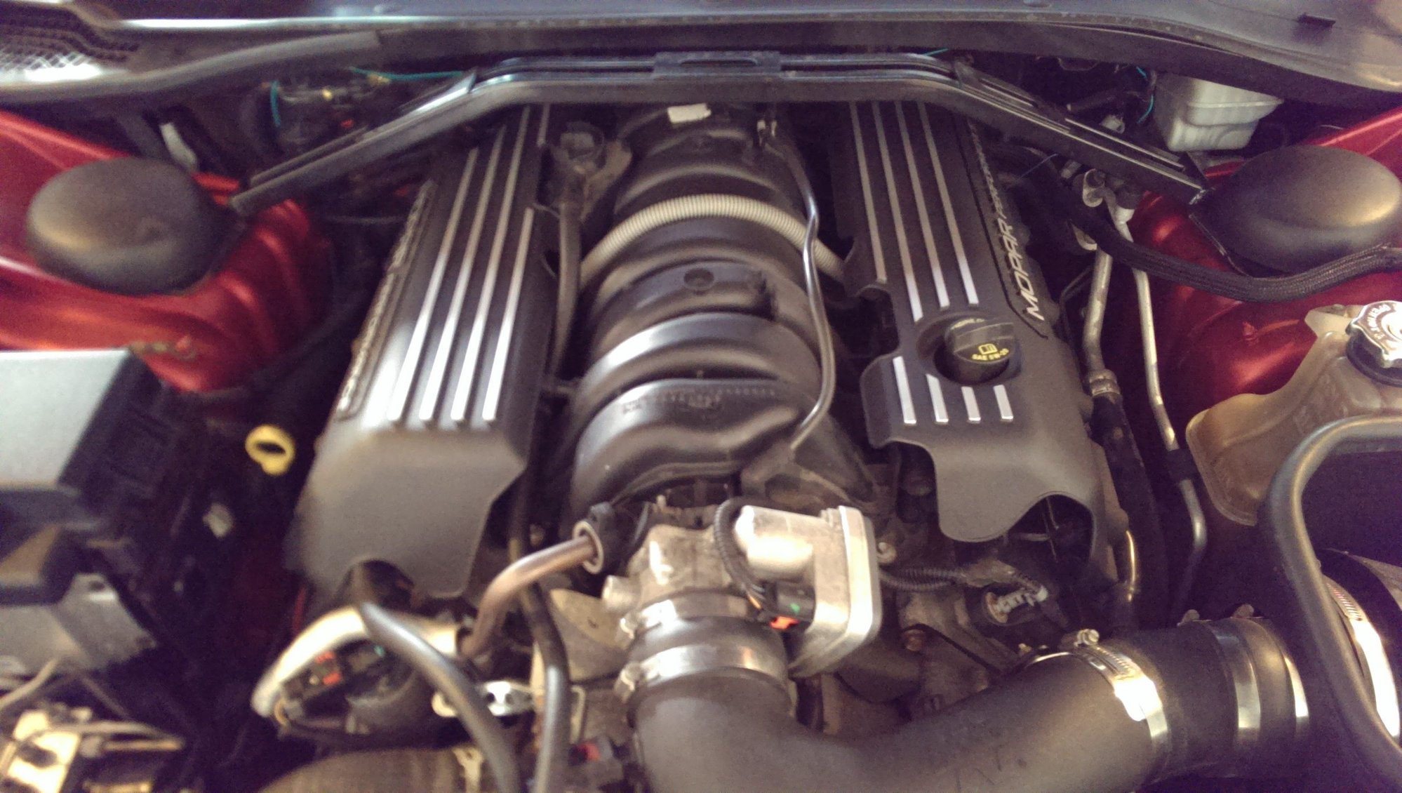

Dress up is fine, but almost $600 for coil packs a certain color with no other benefit and at least $400 for aluminum valve covers with no other benefit makes for getting bent over for $1000+ lol. Mopar has traditionally always been more expensive than their gm & ford counterparts but aftermarket stuff (even just dress-up) has gotten ridiculous. I might've sprung for the VC's but painted the coil packs. I didn't bother with any of that because of price and I like the look of the coil covers:

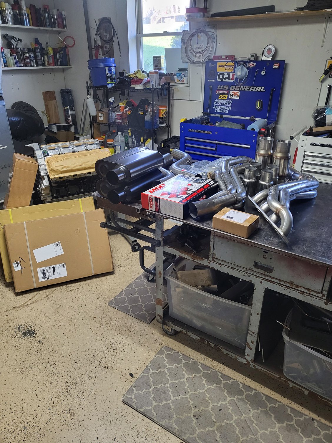

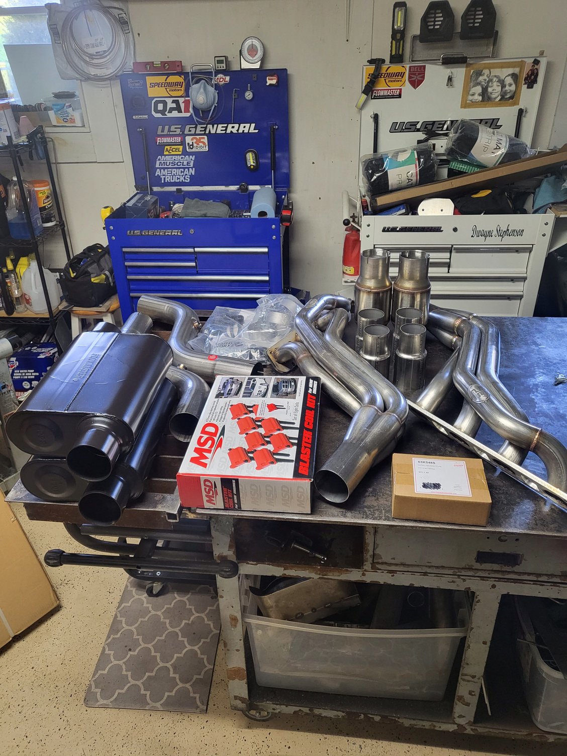

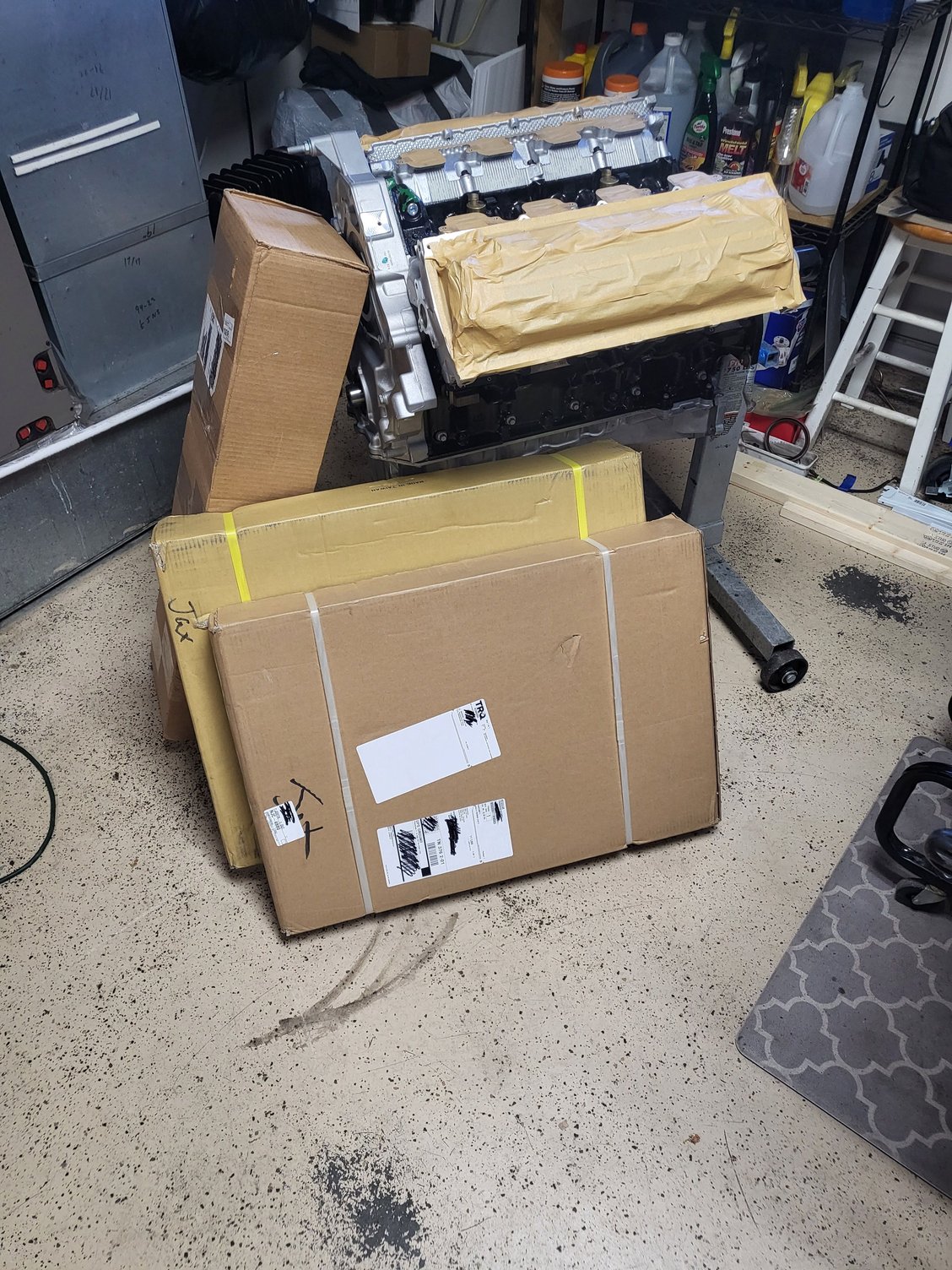

I piled all the parts I have received on the table and took some pictures. On the table you see the headers, mufflers, cats, mid pipes, clamps, MSD coils. You can also see the engine on the stand. I have taped it up a little to keep dust out, but Im also going to paint it hemi orange. In the boxes we have the lug nuts (small box on the table) and the radiator support, the condensot/dryer unit, and the radiator.
On the way are an X-pipe, the wheels, and the supercharger. With the supercharger I ordered the BOV pipe so I didnt have to chase down someone to weld aluminum for me, and the matching overflow tank. I got the supercharger in black, and the other parts are also black to match.
I still need to buy the fuel injectors, a 3 bar MAP sensor, a fuel pump, and an intercooler. And a few other items.
I might get the valve covers soon, but Im waiting on the other parts to come in, and I have to see how much the tires are going to cost me. Im also looking at wrapping the headers. They are stainless, but they are raw. Still havent made a cam choice. I want to make sure I dont ruin the car. I want it to run well, but I dont want it to be a pain to drive. Im going to have to really research this. Im also looking into HPtuners, and a dedicated laptop for it. Im on the fence about adding gauges. I dont think I NEED to see how much boost Im making all the time. There is nothing I can do about it anyway. But If I do, I might also add a wideband, and put both gauges in a pillar pod. I dont really know yet.

Tell me you don't know what you're looking at without actually telling me lol......look at the first engine again. Bottom one is a 392 yes....top one is an 06 5.7 (hence why the covers say 'Mopar Performance').

Yep. That top one looks a lot like a 6.4 until you look at it. I didnt know they even had those covers for them. Ive only ever seen them on the 6.4.

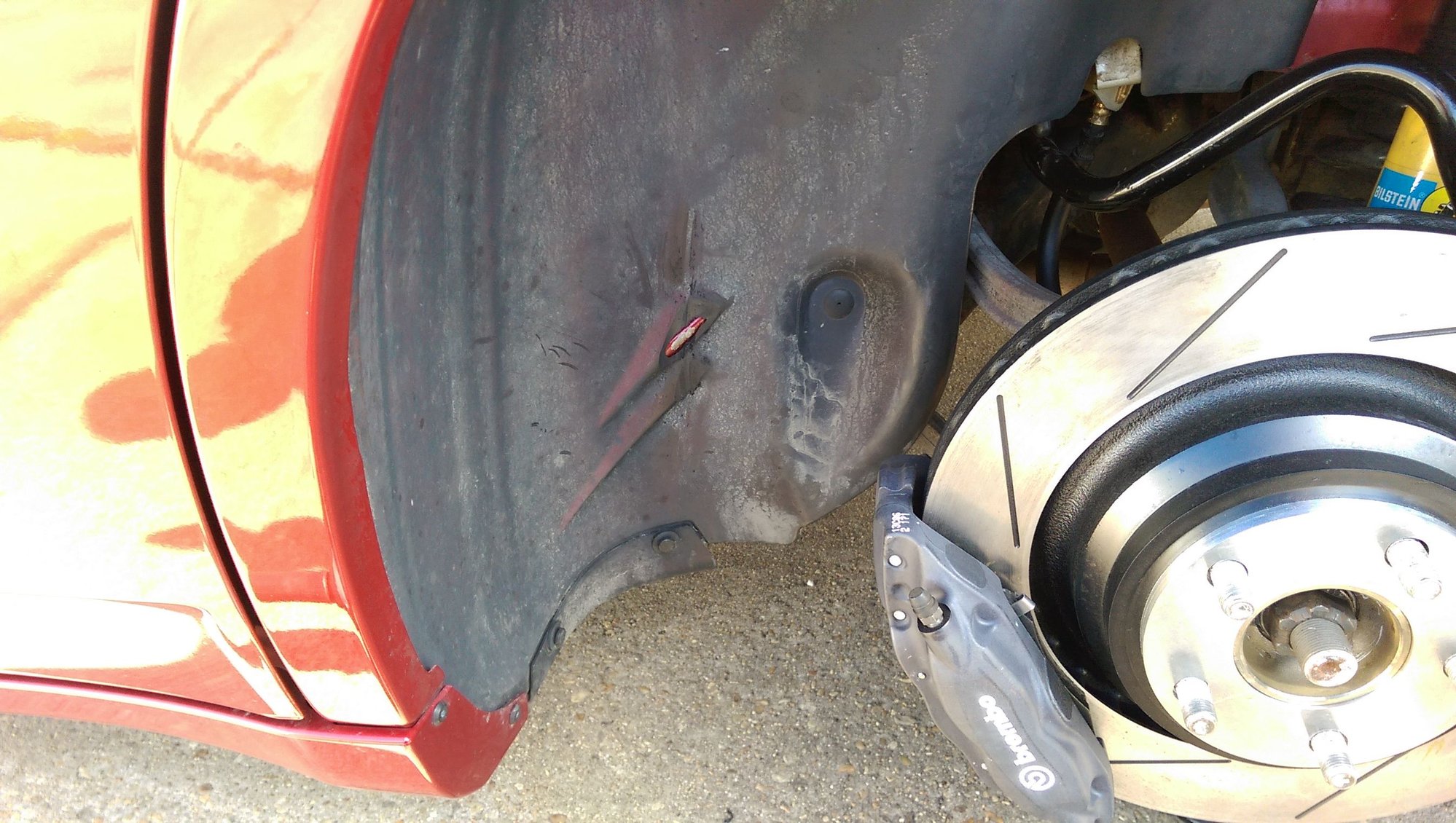

Most likely isn't a height concern, they're probably just a hair too wide. 305's aren't a great fit in the back of 1st gen LX's even with the proper wheels. I had to downsize to 295's. See if this is where it is rubbing:

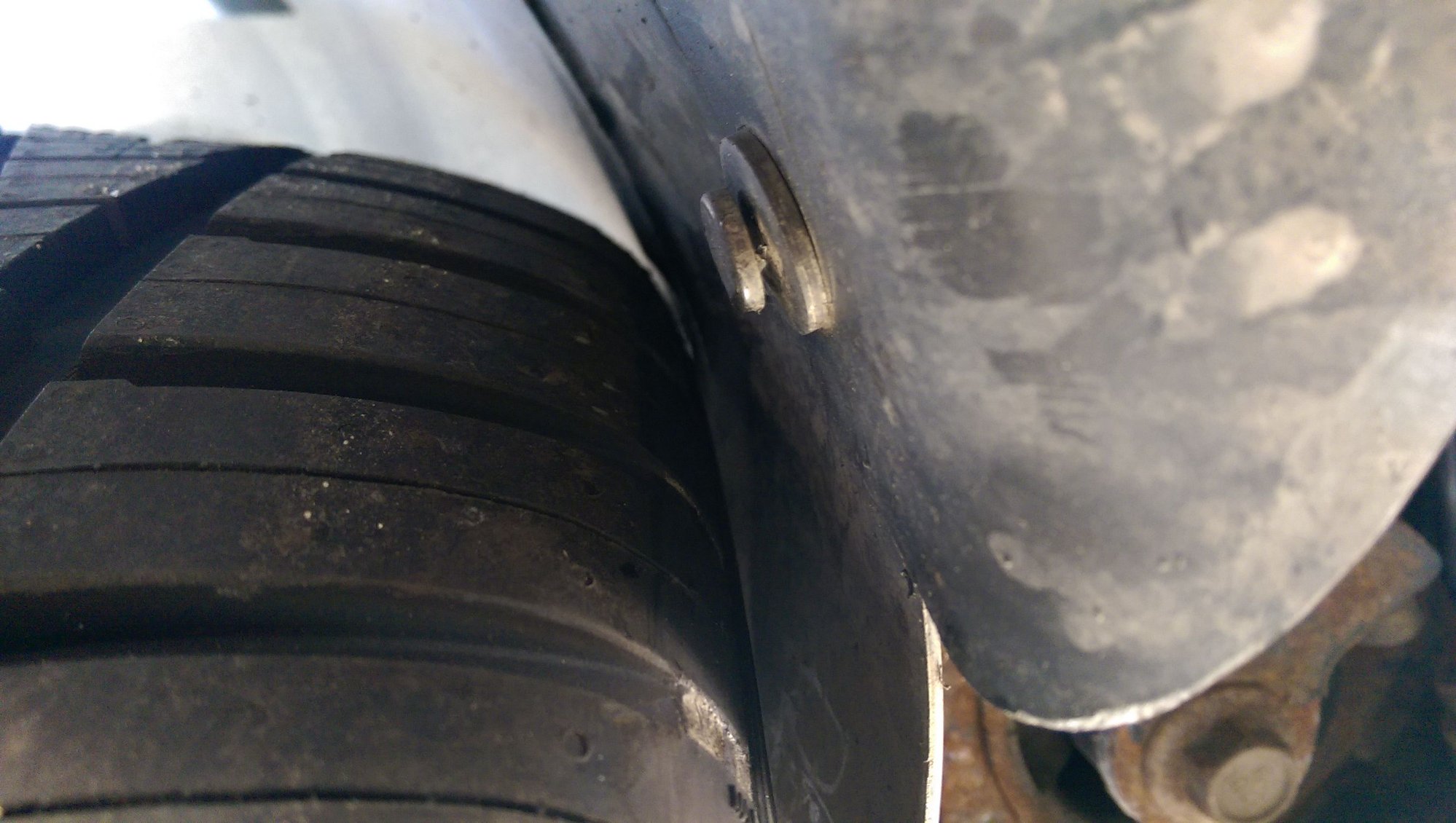

Mine doesnt hit on the inside. I jacked it up today and looked. Its the outside lip. It has cut into the outer edge of the tire. I guess the 305s are a bit big. Ill get 295s next time, but this is what I have now, so I have to deal with it. It only scrapes on my side, because Im in the drivers seat. With extra weight, like a passenger, it would probably be both sides. I rolled the fender lip a little, but I dont think it was enough. I might have to get taller rear springs. I forget who I got the coil overs from, but the rear springs were always really short. I put them as high as I felt comfortable, but the rear spring adjuster is maxed out, and the front springs have plenty to go. I could adjust this thing down probably another 2" if I wanted. Ill keep an eye on it, and maybe roll that fender lip again.
