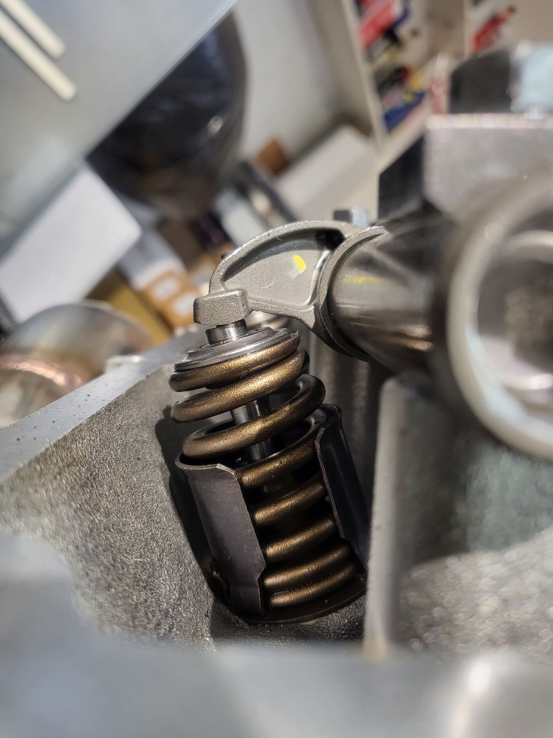

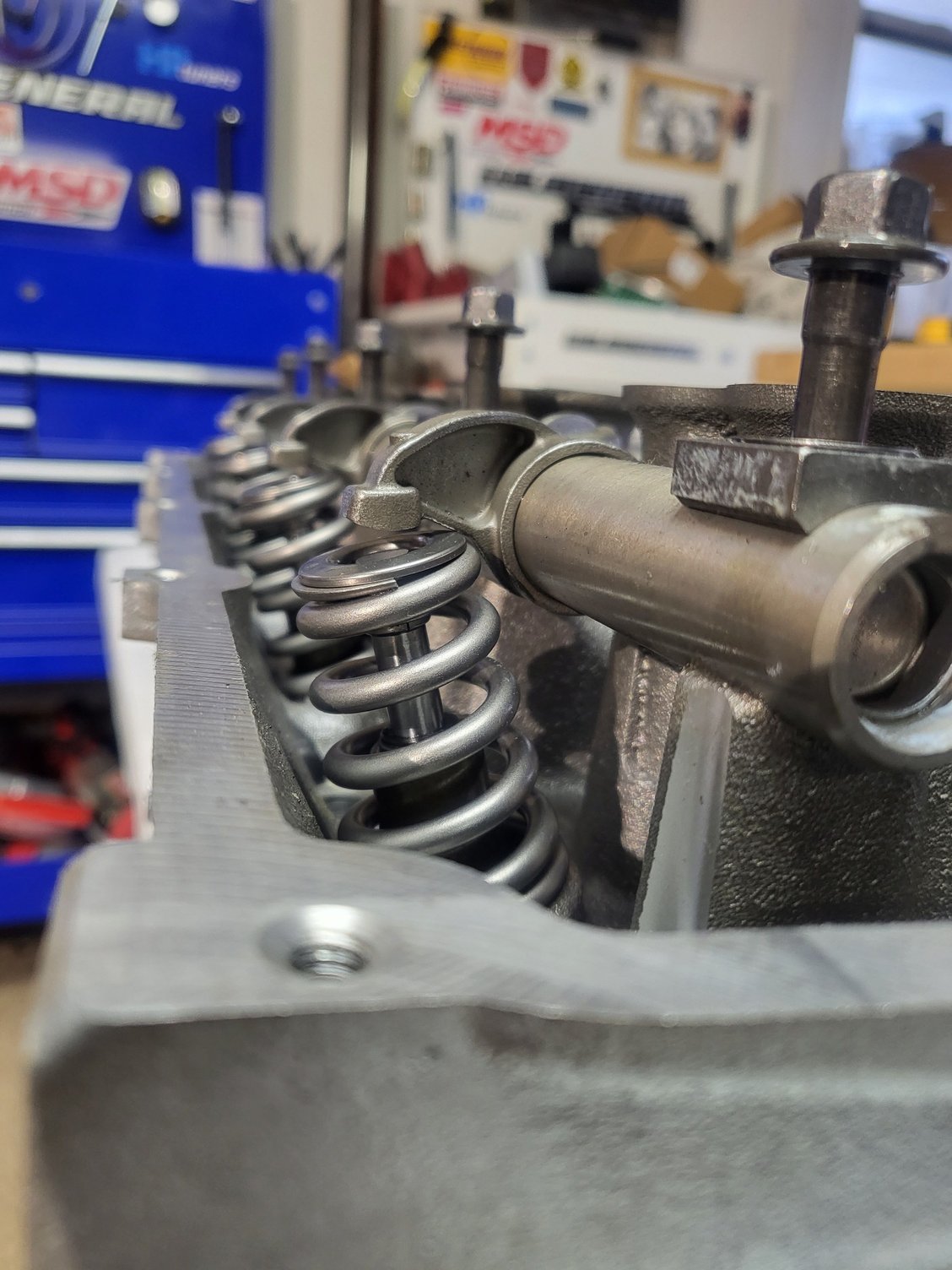

Started installing the springs today, and getting ready to install the cam. I ran into my first issue.
I ordered a Comp Cam 112-337-11 cam, with .635 lift and a .117 degree LSA. On their website, Comp cams suggested I go with their conical springs (P/N 7228-16) and they suggested I use the hardened retainers (P/N 1774-16). After installing the 4 springs on the drivers side head, just for kicks I set the rocker shaft on the supports and found this (picture below).
The original retainers allow the spring stem to sit higher. With the new retainers from comp cams, the locks sit way deeper into the springs. I have sent an email to comp cams and Im sure its an easy fix. I set the original retainers on the new springs, and they might work, but they move around a little more than the others, and they move more than they do on the factory springs. I also attached a picture of the original springs and retainers. This is on the passenger side, and they are installed, but you can still see the problem.
See, the valve is hitting the retainer here
The original retainers allow the stem to stick out further.

I called comp cams, and I bought the wrong retainers. The beehive springs are sort of universal, and they work with several platforms, including the 5.7 hemi. I went to the bottom of the spring web page and it said to use the 1774-16 retainers. After digging a little deeper I realized the hemis have to have the 761-16 retainers. I called to verify this, and they said I was right. The confusion comes from the part numbers, as the retainer web page says they are for different springs.
I just ordered the 761-16 retainers. That should fix the issue.
