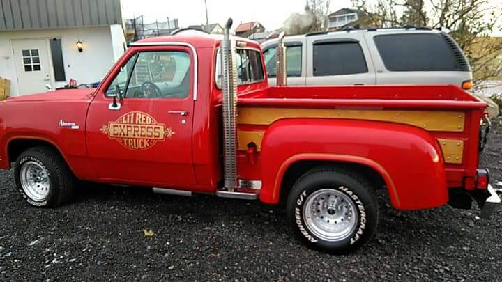

Hi!
Worth mentioning right of the bat - I know NOTHING about these cars/motors/carbs.
Just got a -82 D150 rebuilt as a -79 Li'l Red clone
Seems like it haven't been driven in winter for 10 years, so natually there are gonna be some issues one might not notice/care about otherwise.
1:
Cold, cold start seems impossible. Allmost drained the battery getting it to fire this morning in 24 degrees f. ( new battery, was charged last night )
I tried the old pump-n-turn, but pumping the gas just once or twice seemed to make it worse every time - Not pumping the gas didn't work either.
See the carb in the pics - Doesn't this carb have a manual choke? i se the throttle lever and another wire going through the firewall, but there is no sign of a choke handle anywhere in the cab.
if not, then does it have an automatic spring choke on the left side? - everything looks brand new - and i have no clue as to why it wouldn't fire right up.
