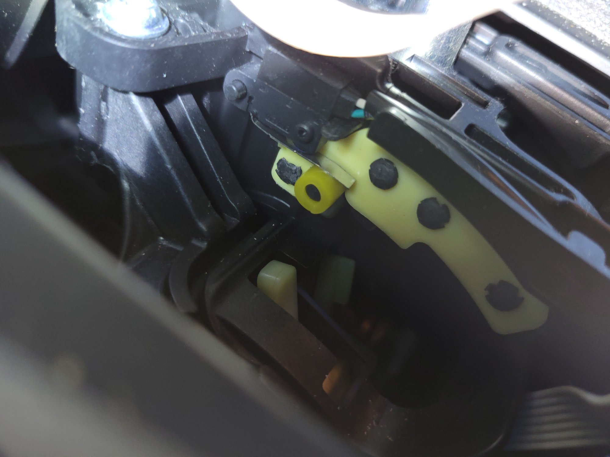

I fixed the vehicle not in park deal this evening.

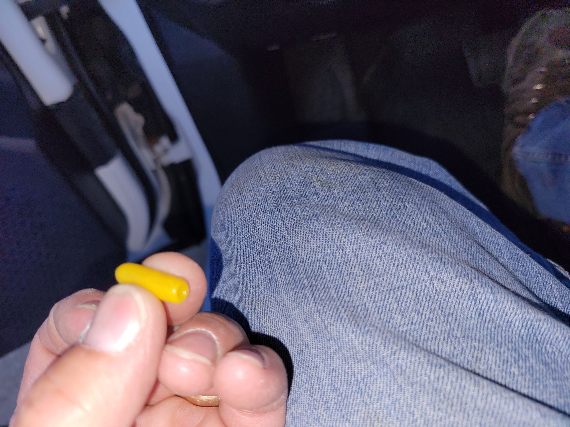

Bending the lever arm on the switch did nothing but make it worse. The little pin that pushes the switch arm up is slightly too small in diameter for such a flimsy switch arm. I took a vacuum cap from an assortment box I had that fit nice and snug over the pin. I cut off about a 3/16" long piece and slipped it onto the pin. You don't want it to touch the white plastic piece with notches that the pin rides under. It just needs to be as wide as the switch arm. This worked great and puts the extra lift on the arm that you need. My guess is this may work on other Dodge vehicles also.
Here us the pin and switch arm. Just pull the shifter bezel off.
Small vacuum cap.

Actually, this only worked for about 6 months. I wound up cutting the two wires going to the switch and spicing them together. This eliminates the ridiculous switch all together and fixed the problem forever.

There are 2 wires going into the switch. I beleive I cut them off right at the switch, stripped a little insulation off and then soldered the 2 wires together. You can use a crimp connector of some sort if you rather. One wire goes into the switch and the other comes out. The switch just lets the power flow through when the lever gets pushed by the shifter. By splicing the wires together, you eliminate the faulty switch.
