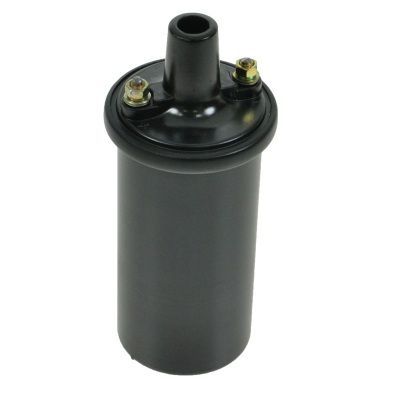

Ok, using this photo, can you give me an idea of where the coil is, and what it looks like, so I can try the procedure to get the gas out? <br/><br/>Thanks.

You cut it off in the pic, It's to the left of the ac compressor. Standard old school coil. Be sure to check for positive with a meter (ignition on) with both wires off the coil. You can look at the wiring for it and find it that way. It's possible they got changed over the years and you dont want to feed 12+ into the pcm.

Looking at the above picture. There are two wires on the left side, the green one and a black one. And there is one yellow and black wire on the right side. Which one is the positive lead?

Like i said it's in the book(wiring diagram) i don't know off the top of my head.
