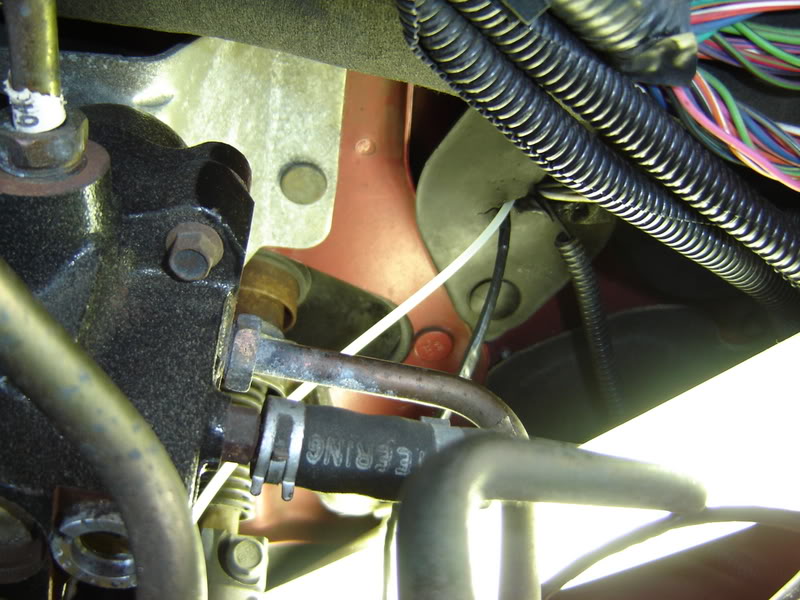

I used the hole where the E-brake goes through the firewall to hook up the Edge. Also you should be able to hook into the fuse block using a fuse block adapter, not which one on an 04

I know you have a newer truck than mine, but this is where I ran my wires through the firewall. It's on the drivers side.
