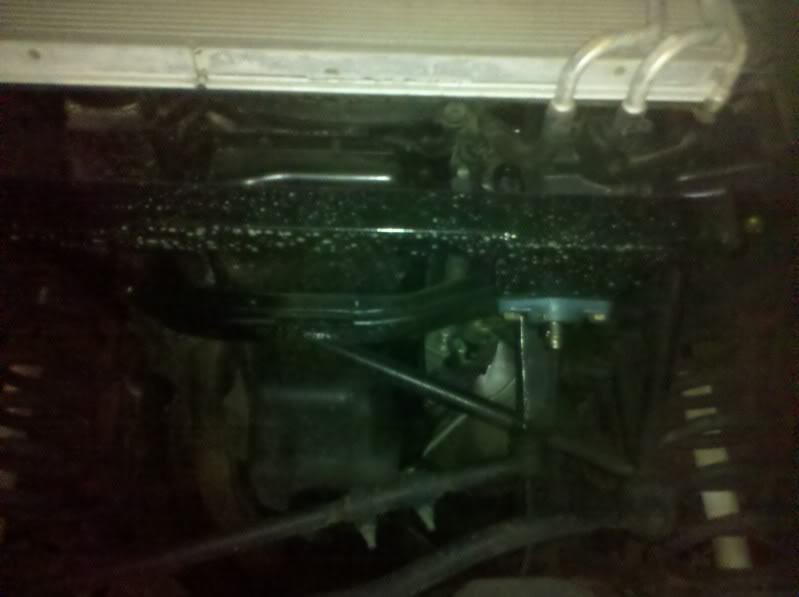

i wouldnt let the fear of DW stop you from buying a ram, dodge > all. if your really worried about it just make sure it has a steering box stabilizer like this and or double up on the steering stabilizers.
this is also on a truck with a 12 inch lift on 40" tires, no DW yet and it has a bad ball joint at the moment.
