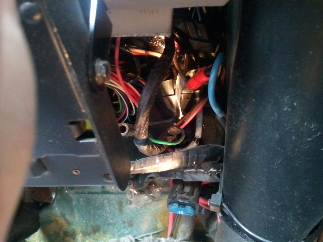

Well, since I have nothing else better to do, I'll get a photo for ya
In these photos, the steering column is the black object on the right, this is looking right under dash above brake pedal. that green wire with the round hole plug is the one you want.
This worked like a charm on my 1994 B350. I happened to check the build sheet, and discovered it came with factory power remote locks. I checked under the dash and found the green wire mentioned above, so I was ready to dive in.
