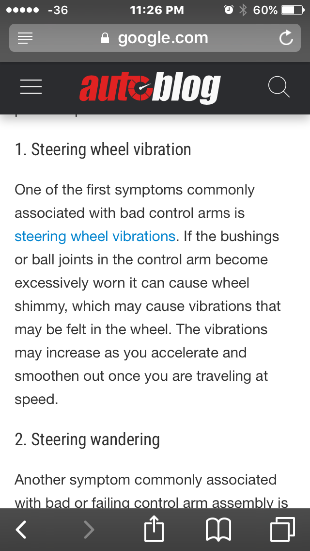

Maybe the guy was right about the control arm bushings. My symptom exactly- vib. on accel. disappears with foot off gas. That's next- closing in.
