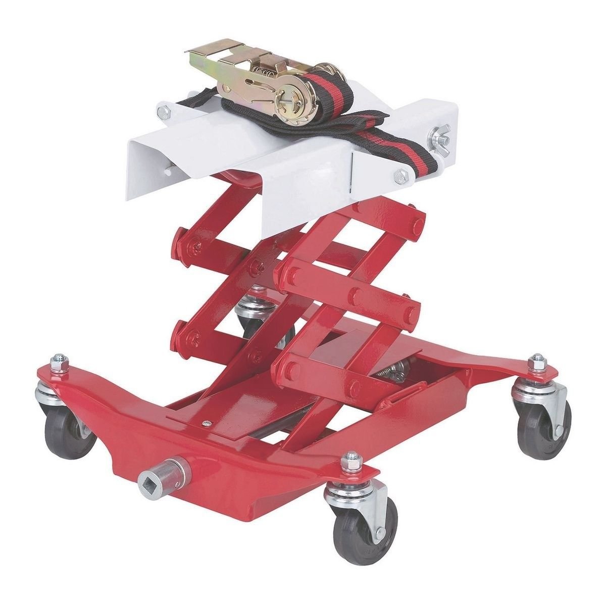

2. I believe the jack is a cradle type like this. Ok to lift/support it directly under the pan? Or maybe forward of the pan under the bellhousing (blue arrow) OR rear of the pan (green arrow)? I'm guessing it'd be off balance though.

My transmission jack has a cradle the pan sits in to support the tranny from the pan. It also has a strap that wraps around the tranny so it wont tip off the jack.
I had to muscle the transmission off and on the trans jack so I could slide it out from under the van. If you raise the van up high enough to begin with you may not have that problem. But then it gets too high and makes it difficult to wrench everything loose and button it back up.

Instead of renting, I decided to buy the 450lb Harbor Freight low profile scissor-style trans jack.

I think we have the same Harbor Freight jack. Throw that chain that secures the trans onto the jack in the trash and use a ratchet strap instead. You do need to strap it to the jack or it is very unstable and close to your body under there. I also cut a thin piece of rubber the same size as the jack square pad that the pan sits on. The 4 bolts on the jack plate stick up and I didnt want them digging into my trans pan. The tilt adjuster on the jack works great and both directions will be implotant during the stab back in. Keep the trans flange and the motor square during insertion.

You must be thinking of the 800lb jack. I picked up the 450lb I linked above and looks like this... pretty bare bones.
I already cut some heavy rubber to pad the jack platform like you suggested.
