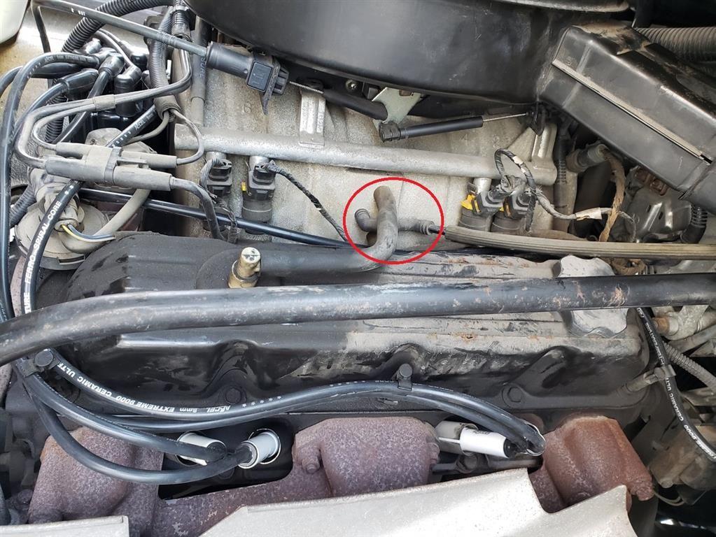

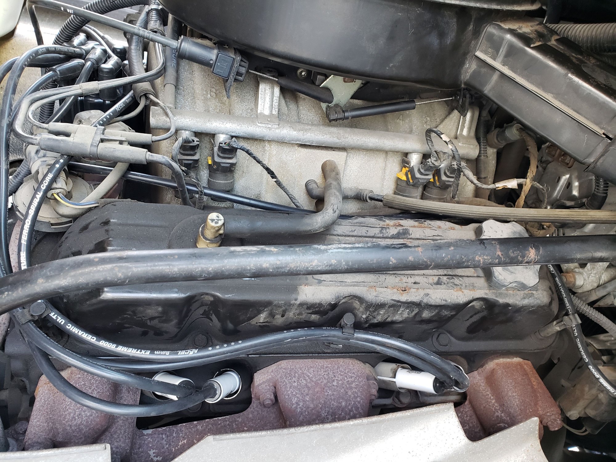

looks like this is the check valve, no? (white elbow valve)
check valve (white/dirty looking elbow)

Busted Nuckles, i see which one you meant (the black Z shaped one). isn't the white (grey) one also a check valve?
Old Oct 12, 2020 | 07:38 PM
Posts: 87,409
Likes: 4,214
That white feller is the PCV valve. I am not seeing any check valves there, at least, not that I recognize.
