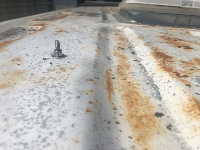

First, I've always had a little of this roof separation, but it has gradually gotten worse.
This is spreading among the support beams. I invoked a simple fix of drilling a hole and bolting it back to the roof.
Did a total of 4 bolts and it's better.

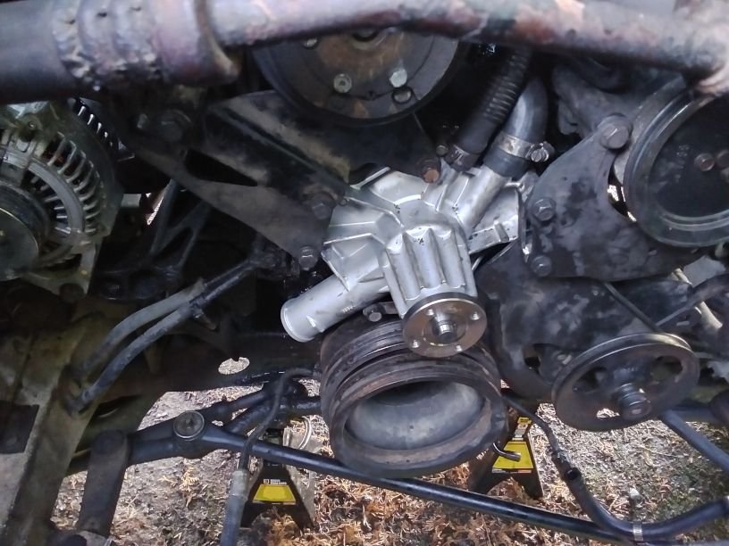

So later while idling in a parking lot, I noticed my temp gauge climbing. When I got out I could hear fluid hitting the ground. Sure enough, right under the pulley, coolant was draining out. Steam was blowing and hissing from a location I couldn't see. I had the van towed.
I surmised when I got home that it was probably the water pump. I would attempt the repair. If it was anything else other than that or a hose causing the leak, the van could have been in trouble!
I referenced both the factory manual and the Haynes. They had similar instructions but the factory manual stated that the air pump, alternator, power steering pump and their respective mounting brackets had to all be removed. Furthermore, since I had A/C I was also required to remove the radiator. I guess people without AC are not required to remove the radiator. And of course, the fan/pulley/ and water pump have to be removed/reinstalled.
It's a lot of work, but it's not necessarily hard work, unless you factor in all of the standing/lying down back and forth business. That alone wore me down. I didn't want to stress over this job so I took my time and worked on it a couple of hours here and there over the course of four days.
One of my biggest frustrations had to do with the sheer number of bolts and bolt sizes. It was as if every single component used a different size. A bolt holding in the alternator is a different size from the one holding in the PS pump is a different size from... on and on. Some nuts and bolts I couldn't match to any SAE size I had and I had to use metric tools. None of this stuff looked new or replaced. That was my biggest trouble by far.
I also highly recommend photographing the bracket positions. Some brackets overlay with others and use spacers - all important to establish particular clearances of the belts and neither the Haynes nor the Chrysler factory manual provide details. It's possible to have it reassmbled incorrectly and it might feel right. You'll know when you go to put the belts on.
One thing that kind of ticked me off was the instruction in the factory manual. It gave specific instructions for removing all of the belt driven components and the order in which to do it. But in working on it, I realized that the air pump and the ps pump did not in fact need to be removed at all - only their brackets needed to be unbolted and they could be pushed aside enough to slip the water pump in. I could have saved a lot of time and energy. The Haynes on the other hand, mentioned just undoing the brackets enough to get the pump in, which was consistent with my observation.
As you can see the water pump on these is the center connection piece for all of the belt driven components.

Inspecting the old water pump, it didn't appear to have blown the gasket. It seemed fine except that you could tell it had discharged through the weep hole, and it looks like this wasn't the first time that happened either. Also, I noticed when spinning it there was a coarse low rubbing sound. The next pump made no noise when spun.
