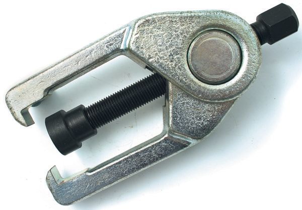

I prefer this kind of tool
Harder for it to bend... if you can get it to fit in there. Haven't done a ball stud just tie rods and drag link with it.
The first picture looks good, but the second picture it seems the tool is affixed in a way where it is putting lateral pressure on the joint. You need a straight shot up and down.
