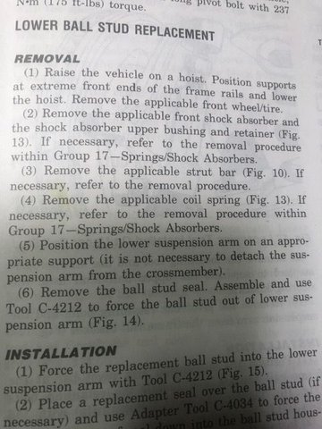

You aren't lying - and this is why the lower ball joints remain on my B150 - I need to order a spring compressor. Here is what the 1990 Chrysler manual says about lower ball joint removal -

my hayes manual literally just says pull the control arm off and take it to a shop haha!
I have a ball joint press and have watched some video of people using it, it doesn't look too bad but I always say that before a 2 day projects turns into 2 months
