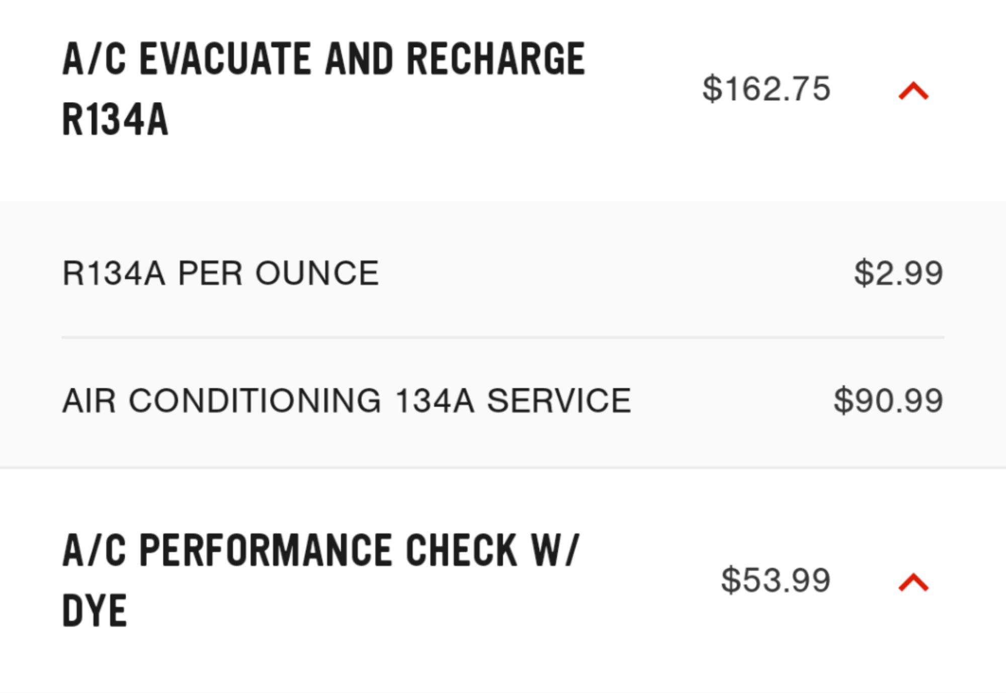

I pulled up the quote the shop gave me back in November, when they checked all the AC lines for me and said there were no leaks at that time but the compressor was nearing the end of its lifespan and major service would be needed within a year. Does this look legit, and are they forgetting anything that isn't included because this is a significantly expensive repair:

Labor is what kills ya. That, and I think their parts prices are a bit high... But, it's a shop, so, not really surprising. That is probably reasonable.... Best part is though, you don't have to fight with it, and you get a warranty.

Thank you That is true. I forgot about the warranty. That definitely has value to me. I thought the same, labor while expensive was reasonable but the parts seem high.

See if you can find a place that will work with your parts. It used to be common practice back in the day but now it's pretty rare. Still, there is a shop close to me that works with customer's parts if they're new in the box. Might save quite a bit if you can find a place to work with you. You typically won't get a warranty with it this way... but what they want $729 for would cost you <$200.

Yeah, I wish I could do that. But near me, there are only corporate shops so they won't use my parts - I have asked. And I believe they are quoting the full replacement kit, not just the compressor. But it's still 2x what I would pay at AutoZone/AdvanceAuto/OReillys here.
