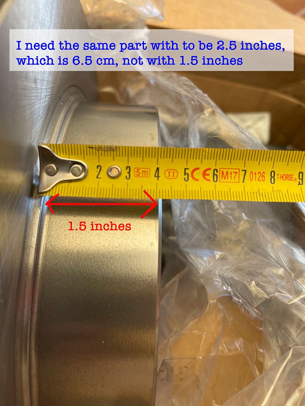

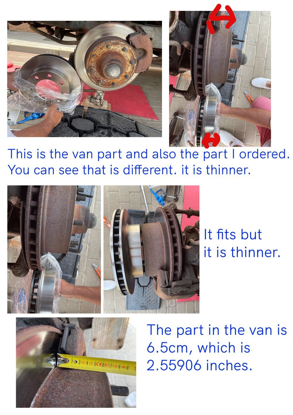

Hi, I am Grace, from Spain and i have a Dodge Ram B350 1992 5.9l V8, and i having a problem finding the front drums for my van. I am wondering if anybody here you help me to find them.
I have purchased already a set of front drums but they are not for my vehicle. I have attached the part i arready bought and now I am trying to find the Drums I need to buy for the van.
if anybody here have any kind of information which could help me to find the drum I need I really appreciate!

I don't think those are correct. Or the ones linked by the grouch. It appears to me that your rotors have the hub incorporated into them, so, rebuildable bearings. I can find rotors for the 3600 lb front axle, or the 4000 lb front axle, but, not for the 3100 lb axle. Which strikes me as kinda odd. But, I think you are looking for something more like

You could look on eBay or Amazon for RAYBESTOS 76920R which is your front rotor, or you can get it from Rockauto which is based in the USA but does ship internationally.
