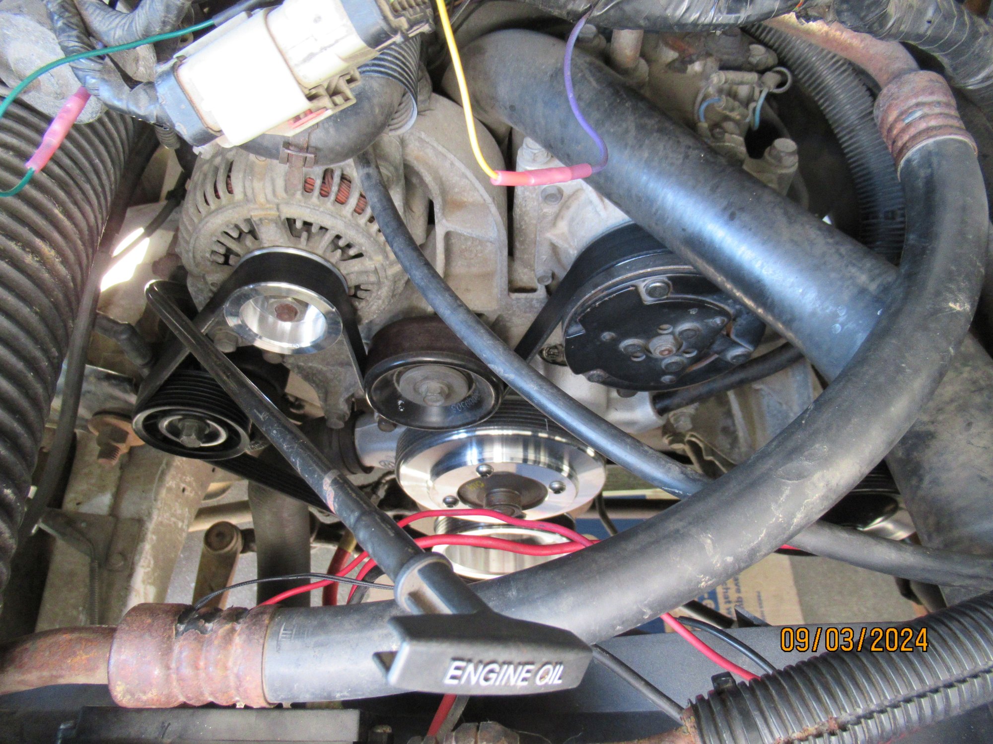

Thought I would include a pic that shows how much room I have in front now.

You’re going through and replacing the pulleys for lighter weight ones to improve performance? Love the extra room with the mechanical fan and shroud removed.
With the dual fans are you doing anything to increase alternator output? See my posts on alternator selection as I *think* I may be seeing my battery discharging at long idles on my Ford pickup.

They are not only lighter, but are under driven to free up more horsepower and look so much better. I had no issue on my Ford van that the fans came off of and it had the same under drive pulleys on it.
What voltage are you seeing on the pickup and why do you think it is discharging?

What do you mean by “under driven”?
On my ford truck, with a new battery, I see the battery gauge bouncing on the dash a little when I was sitting idling for a long time at a drive through. It was at least 10 minutes. Drove home and it was good while driving. Parked. No issue with AC off (presumably the fans were off). AC on and it started wobbling again. Haven’t gotten a multimeter on it yet.

Larger pulley on the driven whatever. (alternator, power steering pump, water pump, etc.) They turn slower, so, less parasitic drag on the engine.

The fans should cycle which may be the bouncing you are talking about on the volt meter. With ac on they should be running all the time.

Interesting. And here I am thinking I need a smaller diameter pull on my alternator.
@jeffersonracing , I’m sorry if I took over your post. To answer your question/statement, the fan would have been on constant since the AC was on. The battery meter on the dash was bouncing at like 1-2 hz or so…

The smaller pulley goes on the crank, so, for each revolution of the crank, it doesn't move the belt as far. Putting a smaller pulley on the alternator as well, will keep the alt spinning near stock speeds, which is really what you want anyway, otherwise, it tends to not charge at low RPM.

Not sure how your fan operates, but this fan is activated any time the compressor is kicked in, if I did the wiring for it. The compressor also cycles on and off.
