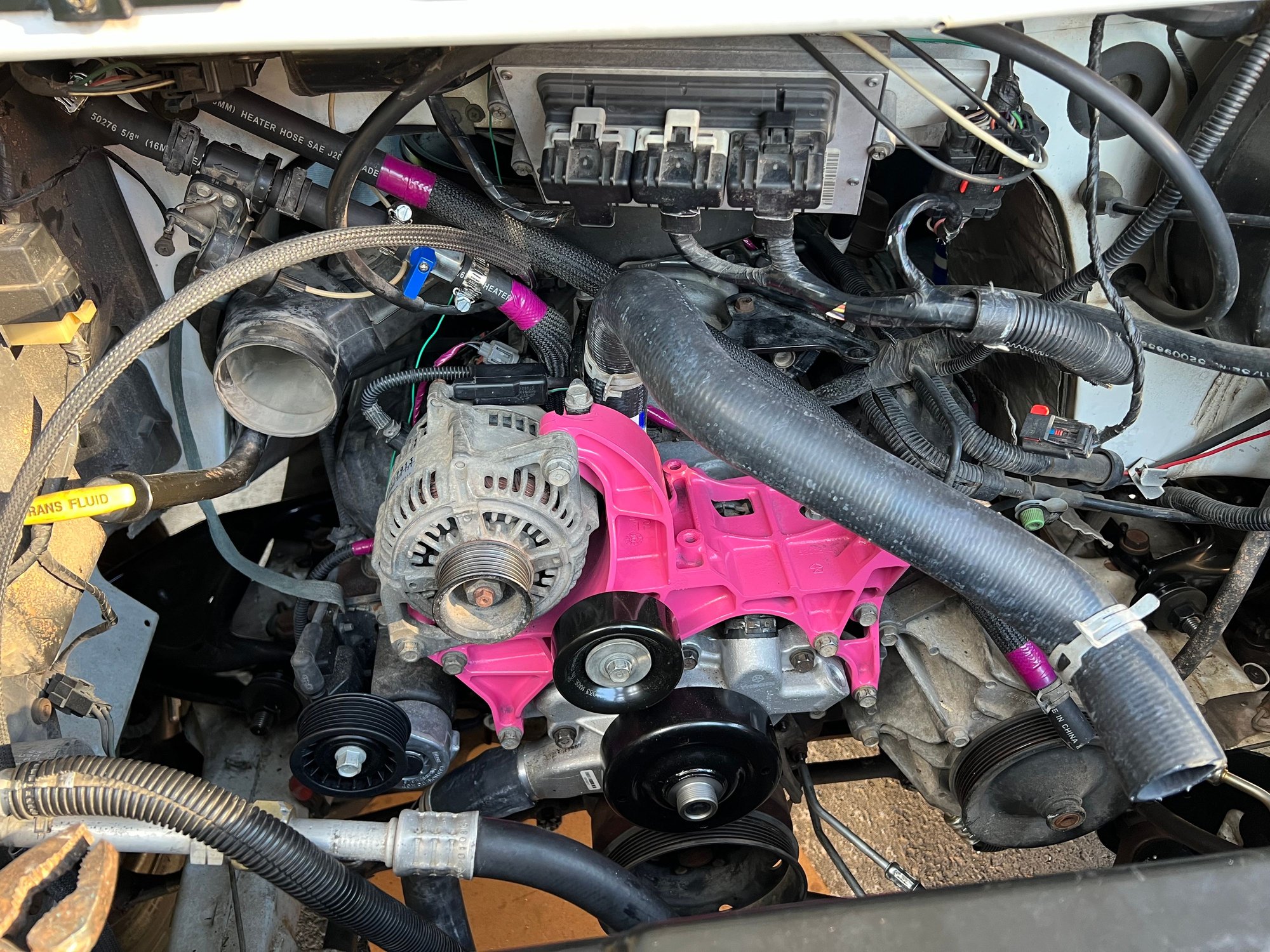

I'm thrilled to say that no intake bolts broke removing the intake.
And the harmonic damper wasn't even worn where the seal rides on it, so I didn't even need to use the sleeve that Felpro provided in their kit.

The van is at 100,000 miles (almost exactly).
The timing chain had 5/8 inch of deflection. The new double roller I bought from Hughes has 3/8 inch deflection.

The radiator cap is worn out. (The return spring on the coolant siphon valve is shot)

I decided to take advantage of the intake being off and had a look at the carbon buildup on the valves with a borescope. I don’t know about you, but I expected to see a lot more carbon than that. I’m not even tempted to clean them. OK, well, if I’m honest about it, I AM tempted, but I’m not going to. Haha!

If it ain’t broke, paint it hot pink.
