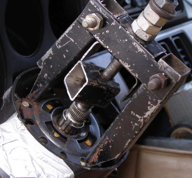

The puller came together, a bit over an hour of hack-sawing pieces of tubing and looking for bolts and studs to make it all work:
I'm not totally out of the woods yet, the horn contact ring got damaged and so there's no horn at this stage. I'll be looking at wreckers for the bits to replace all those damaged. The puller is the key to it all, it enabled me to get the bearing all straight and the circlip in very easily. For now the job's done.
