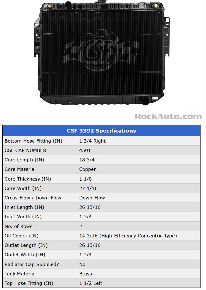

I've been looking at a few. Including a CSF 3392 from Rockauto for $260 shipped plus tax.
Then AlloyWorks has a 4 row aluminum for $260 shipped plus tax or a 3 row aluminum with e-fan/shroud for $310 shipped plus tax. They are sold out of the 3 row without fan for $180.

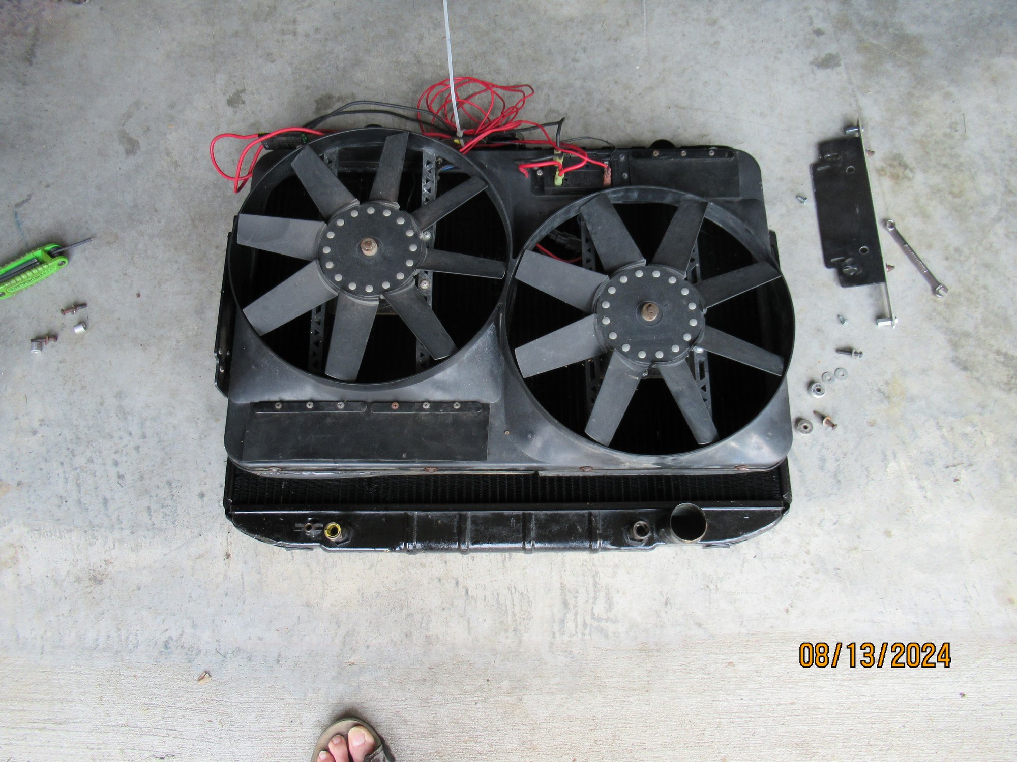

What ever you do I would not go with that alloy works with the e fan in the middle. That shroud blocks off way too much airflow through the radiator and the controller looks to be worthless with the temps it turn on at. 185 is lower than the normal running temps so it would be on at all times. I have run a flex-a-lite unit on my old Ford van and have moved it over to my Dodge. Can't really say I've had any issues with it. I don't live in AZ though. There's more info in the thread with the title A couple of pics just above this one.

Jeffersonracing, I was actually checking out your post right after posting mine. I enjoy what you have going on and saw you're doing fan conversion as well. I was also a bit concerned as the shroud did have only a few extra feed through slots for air.
I watched a comparison video of champion radiators vs these alloyworks, most were very impressed with them along with using 5052 aluminum. I really wish they had the 3 row in stock for $180, seems like a great deal.
I probably will end up going with the CSF from rockauto although CSF is made in china now I believe. Unless the 4 row aluminum for same exact price would be better. I did email them to ask tube size dimensions.
As far as cooling im sure both are excellent but Im concerned about vibration and longevity when it comes to brass/copper vs aluminum. As i do a lot off off-road driving in my van down mountain trails.
So if someone could steer me in the right direction for such application which metal would be better that would be great.

You want those extra slots for air to flow through when you're traveling down the road. The rubber flap bends with the flow and thus allows more flow through the radiator. When the fans kick on the flaps make sure the fans are pulling air through the radiator. There is much more area to flow through than that aluminum one you pictured.
