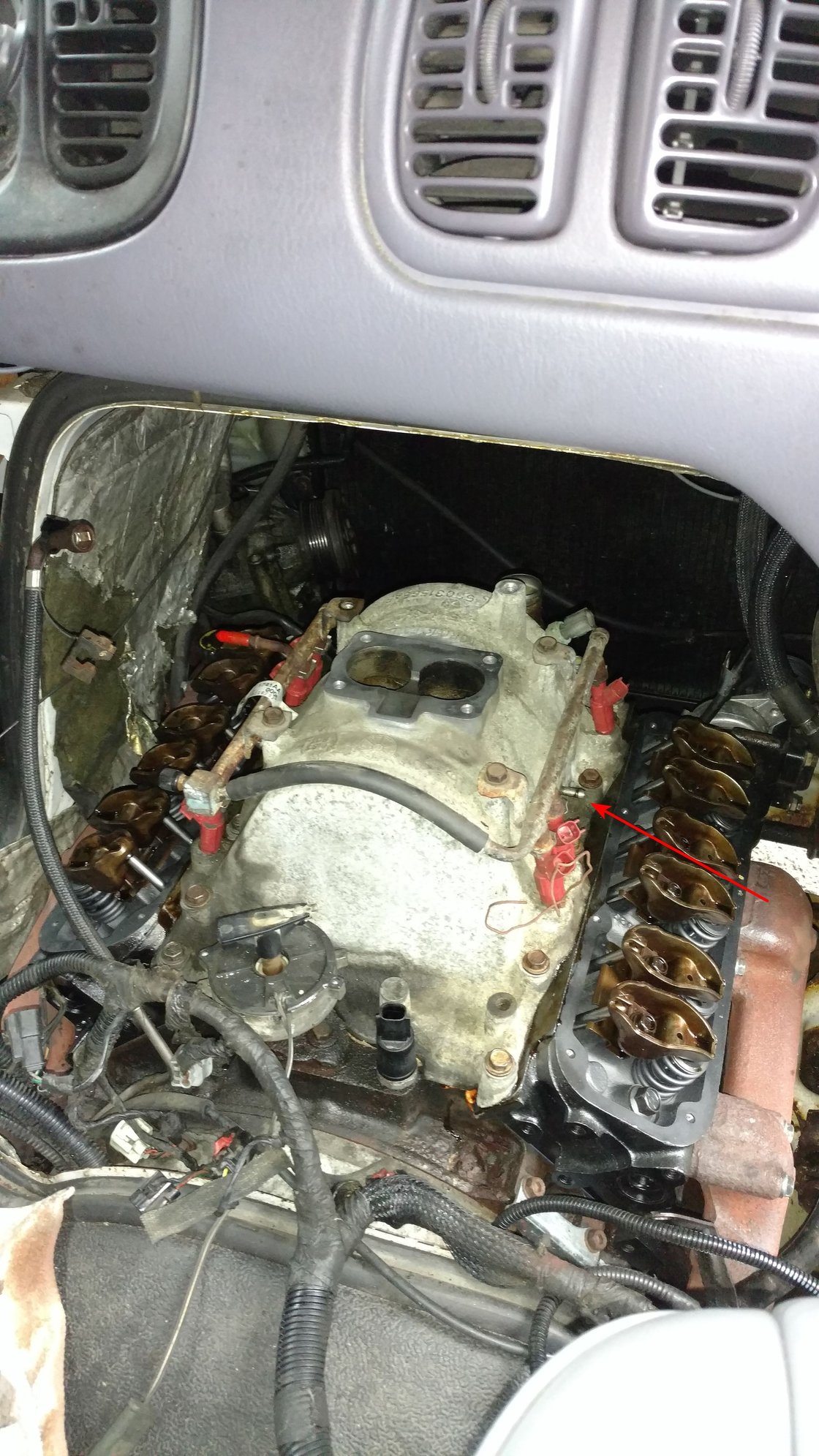

Originally Posted by chatvmax
Can you please tell me where that attachment might be, the location of those hoses where I can look, do I have to remove the engine cover shroud, or is it under the hood from the front? Or even perhaps inside the cab??
You have to remove the engine cover, then the air cleaner assembly. From there, look on the passenger side of the intake manifold, about halfway back on the side of the intake will be a fitting with a vacuum hose, that's the one that drives the HVAC controls. From the intake it runs to the vacuum reservoir located under the passenger headlight.
The red arrow is pointing to the fitting.
