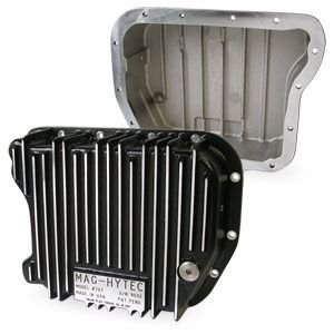

I also bought one of these deep pans to hold more fluid.
Additional benefits:
Allowed me thread the trans temp gauge sender into the pan, rather than tap into a cooling line.
Has a drain plug to allow for easy draining.
Aluminum, so it doesn't flex or bend, which means that the gasket seals well.
https://www.glacierdieselpower.com/p...ansmission-pan
I'll take a look into some deeper pans, it certainly would be nice to have a drain plug and a spot to install a temp sender.
