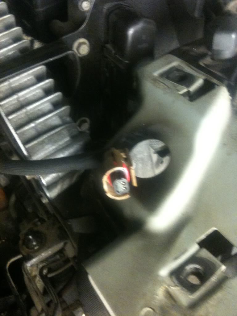

ok im having problems with these plugs.
this plug hee looks like its the knock sensor but im not sure. it snames between the heads, on the rear head. it threads to it, but i cant find the spot to plug this in. look below

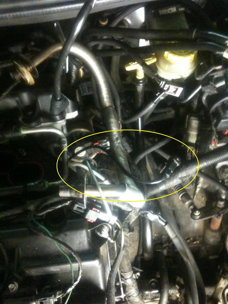

this plug its a 2 piece, its brown and i have no idea where is goes:

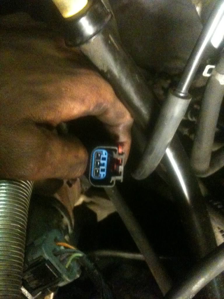

this is a close up:

update never mind the knock sensor. ok here is the issue, the 2005 block the kncok sensor is a stud, on the 2002 it threads in the block, you guys think i can splice the connections and useww the one of thew 2005? because the 2005 block has a stud and i cant remove it, so what u guys think? also the only thing i cant find is the blue plug
