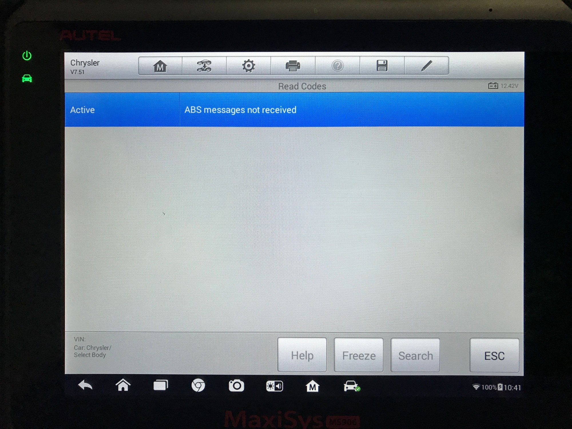

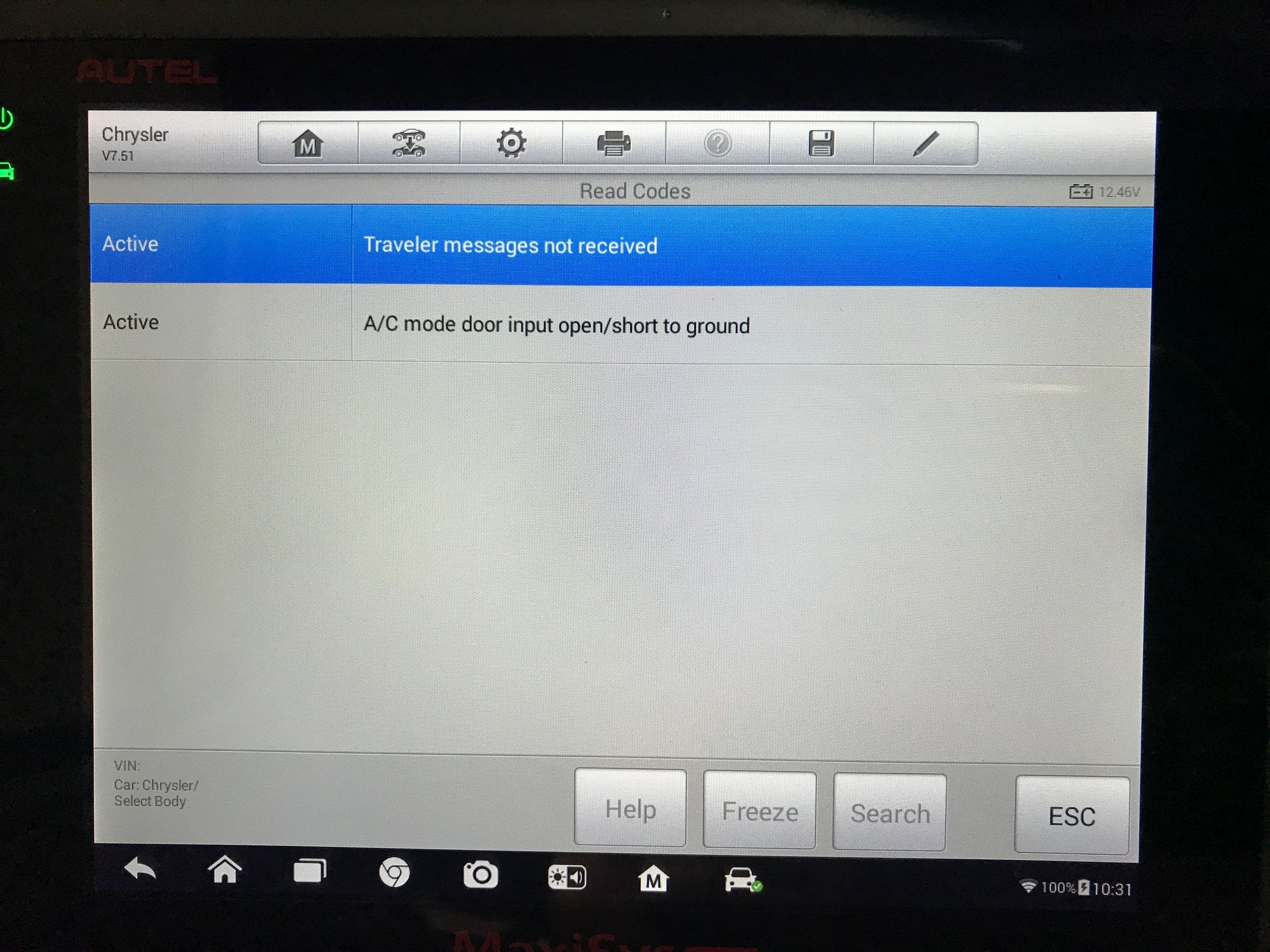

New stuff that popped up today on my diagnostic tool...
Any ideas?
