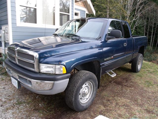

Glad to find a forum specific to v10's. I use Big Blue to haul my Bobcat (331D mini-ex) around and a dump trailer. I haul very short distances, so I'll likely keep him stock...but ya never know. I'm your atypical v10 owner, as I've never owned a brute like him. Gas costs are a serious issue up here in the north, so I use him sparingly.
I will say that when I need a pick-me-up, I take him for a twirl down a country road, logging road, goat trail....I feel all warm inside just thinking about it...lol
cheers, melli
ps - I did change the rear differential (75w-140 syn) and transfer case oil today, and what a difference that made...I thought I got a well maintained truck...FWIW - I got the truck from the feds through an auction.
cheers, melli
