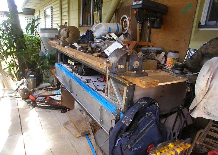

Home workshop bench. The need to carry on preparing things for the gearbox conversion led to me spending time creating this workbench and its lockable compartment for power tools.
I built in a locker beneath the front of the bench so I could secure power tools etc when I wasn’t home.

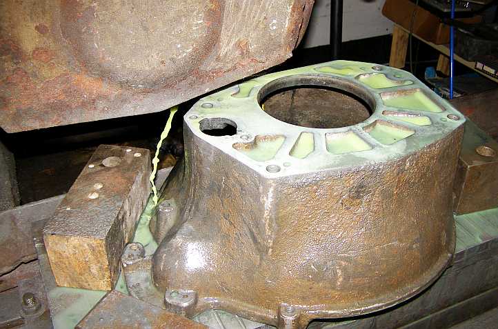

Machining bellhousing surface. Ben’s grinder made short work of doing this job, and doing it well.

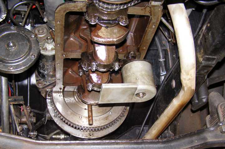

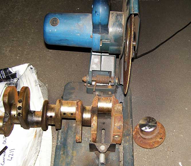

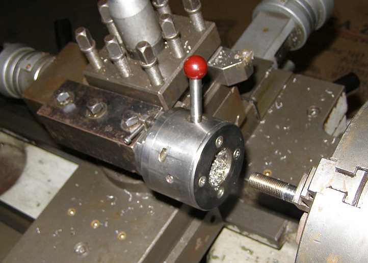

While Ben was getting the head ready I used his cut-off saw to take the rear main journal and flywheel flange off a 318 crank which had a nasty dent in one of the journals from where a rod came apart:
Giving the crank the chop. This crankshaft was damaged so making a part of it into a useful took was worthwhile.
The purpose of this was that I’d be using it as a mount to put a flywheel in a lathe – but that’s really a part of another project. I left Ben’s that evening with the head and the machined bellhousing and took it all home so the man Sandra had chosen to pay money to do the gasket would have the head there ready to go. The idea was that he could then do the job in one day without having to send the head away to be reconditioned.

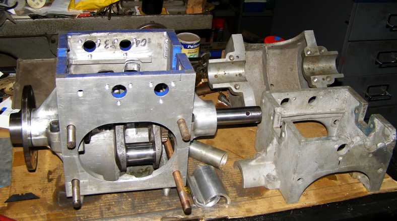

Replacement for Henry’s casting. The original crankcase was over a hundred years old, so it was reasonable to replace it with a new fabrication.

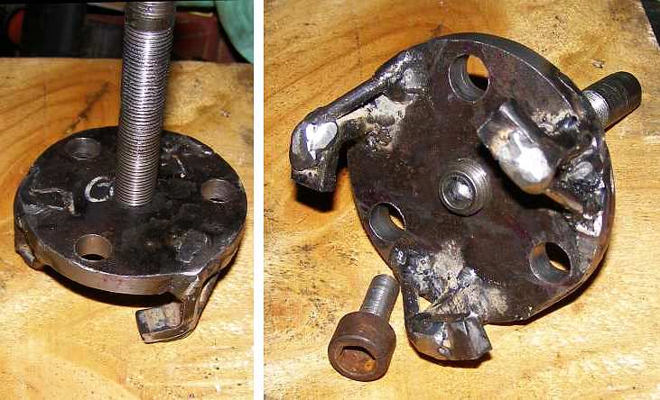

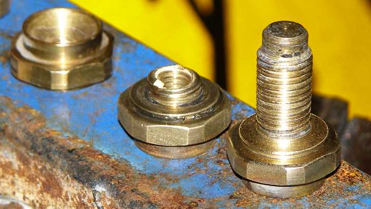

As I talked to him about this he suggested he could help by using his Coventry Die-Chaser to cut the thread. I bought the necessary 7/16” UNC bolts and he would start the 7/16” UNF threads on the other end once I’d removed the bolts’ heads…
Die-chaser is quick! An accurately-cut new thread put into the stud was what I wanted, and I got it very quickly.
…and so another job was done. Just a little job, but the whole project is made up of lots and lots of little jobs. And while looking over the ‘little jobs’ I noticed that I’d been sent the wrong clutch plate and throwout bearing:

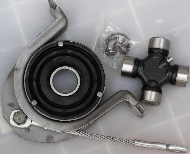

Wrong spline. More mistakes. I was sent the wrong clutch plate and throwout bearing and had to get fresh ones sent from the US.

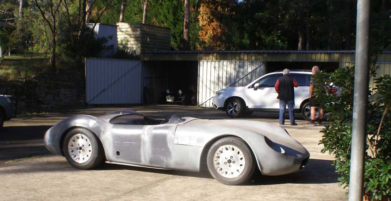

The Maserati look-alike. Progress had been made on this car since my last visit, though there was still much to do. Pat Clarke shows Marc Schagen his Forester in the background.
Classic lines. Spoiled by the modern alloy wheels? I don’t care, Bob’s done such a nice job of all his cars and they’re definitely built to a budget. In the background here is Marc’s 4WD Holden dual-cab utility.

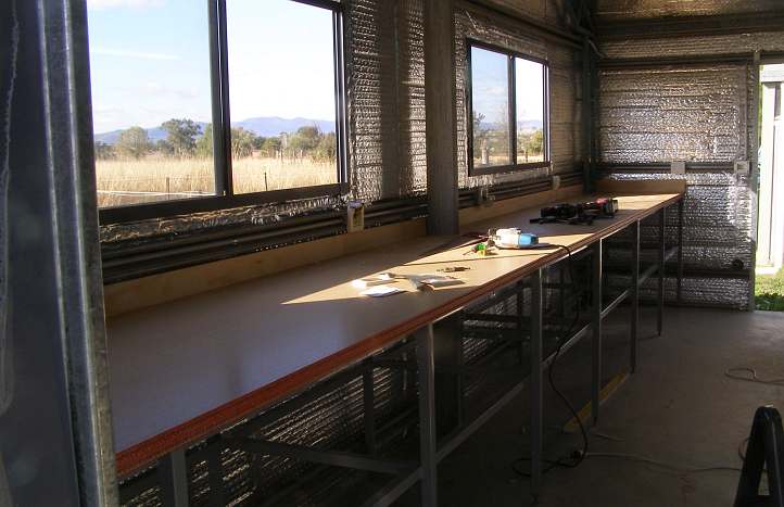

Bob’s bench. Nothing like mine! The new shed was taking shape with this bench and other shelving making it a useful workshop.

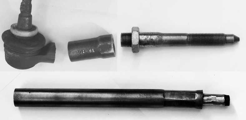

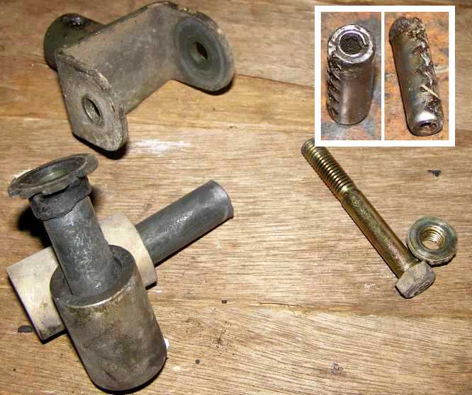

But I was keen to get home and back to preparing the bits needed to fit that NV4500. One job I had to tackle was making a gearlever, the stub supplied was only a few inches long and had a 16mm x 1.5mm thread. I ascertained that this was the same thread as was used on Falcon tie-rod ends and so I relieved a wreck of a couple of these and cut one up to make a coupler to a piece I had in mind to reduce the size to 14mm. This meant another visit to Stuart so he could use his 16 x 1.5 diechaser on yet another bolt I’d picked up which had the thread I wanted at the other end and was 16mm in the shank at the other.
Well, not everyone has the things I do lying around, so using a Peugeot tie rod for the next section of the lever will very likely make it the only one so occupied in the world:
Gearlever bits. Using a part of a Falcon tie-rod end as a coupler to screw onto the stub lever, I had Stuart start a 16mm thread on a stepped bolt which had a 14mm thread at the other end. From there I’ve used a Peugeot tie-rod…
Trial assembly. …before I butchered the top end of the Peugeot tie-rod. I still have to cut threads in further and when I know how long the lever has to be I’ll adjust lengths of the pieces to suit, the final ‘adjustment’ being to the tubular section of the Mazda gearstick.

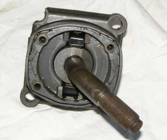

Bugging me about all of this is the plastic housing in which the gearlever mounts. It was cracked…
Broken mount. Good old twentieth-century plastic! Not good enough, it seems, so plans were put in place to find something out of which I could make a better job of it.
…and obviously it’s a weak point, so I started thinking about making a replacement out of something more robust. But I was now ready to decide how I’d like the lever stub bent for optimum placement in the van and a visit to Ben saw the oxy-acetylene torch do its stuff to enable that to happen:
Getting the right direction. The lever was originally intended for a pickup, so I needed to put a different angle on it for use in the van.

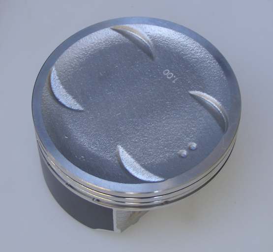

Bigger pistons. These were obtained so that I could get Ben to bore the green Forester’s original engine out to the maximum overbore size.

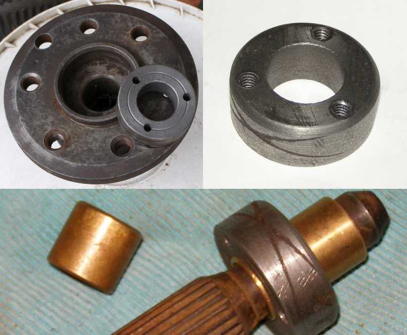

Spigot and dowels. After cutting the front boss from the rusty Peugeot I machined it to be an interference fit inside the larger counterbore at the back of the crank.
I had quite some trouble finding just the right piece of steel to machine up to make this, but I found a rusty Peugeot camshaft among my junk and it had a front boss just the right size for the job. I was concurrently experimenting with making some offset dowels as these are recommended for Mopar gearbox fitment, so they’re shown in embryonic form in that photo too. And putting it all together…
Extending the spigot bush. As that was machined to be a tight fit, I realised that it might one day have to be removed, so I’ve drilled and tapped three holes which will enable me to screw bolts in there to push it out. Meanwhile I acquired a longer than standard brass bush nominally of the correct internal and external dimensions and finished the bore in the support to make it a neat fit too. Finally, linishing the inside of the brass bush gave the required 0.005” clearance on the spigot.
This was only possible because I was able to spend time on the lathes at the Men’s Shed. This organisation is proliferating around Australia and there are actually four Men’s Sheds within 13 miles of home. Of course, it’s the one that’s 13 miles away which has the abundance of metal-working gear while most of the others are largely restricted to wood-working.

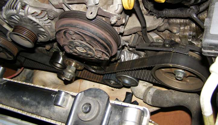

Time for a change. These need to be changed every 80,000 miles and I had one on the original engine which had – if it had been replaced when it should have been – only done about 20,000. So an hour or two was spent on this job.

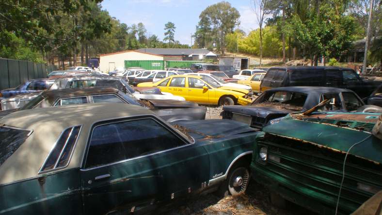

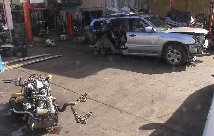

Then a chance encounter at the wrecking yard led me to hedge my bets a little. I spotted a Forester of the same model there which had been very well looked after right up until someone gave it a solid hit in the left rear corner. I negotiated a deal which included me being able to do the work.

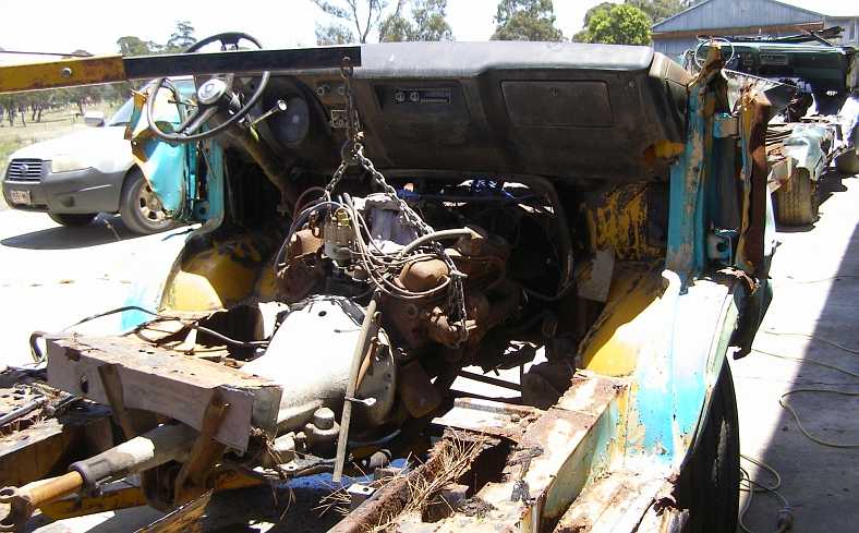

Spare engine acquired. I like to do the work myself to be sure I know nothing is damaged, which is something which can’t be said for the back of this Forester. As it was an automatic it lacked a flywheel and clutch.
In this way I knew nothing would be damaged, nor wires cut, as the engine was extracted. I also got the radiator and fan assembly and three good tyres, handy spares. But this was purely a stop-gap in case there was a delay in rebuilding one of the others.

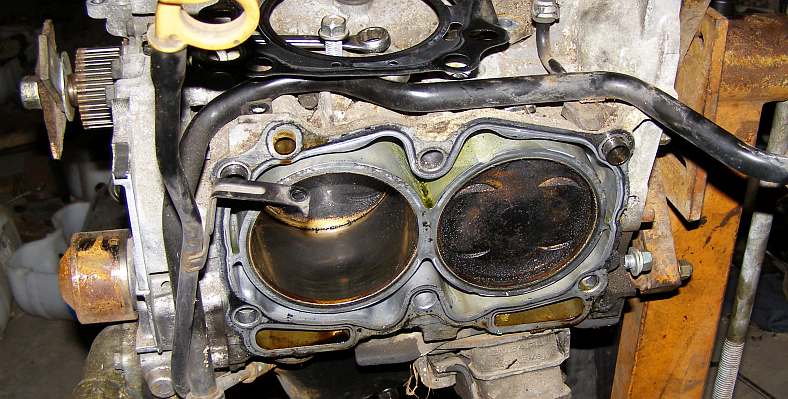

The need to get the original engines of each of the cars into good shape saw me planning in some time at the shed tearing them down. The first one was the poor green car’s engine, which had suffered blown head gaskets. When the heads came off it was clear that the bores had suffered as expected and that buying those pistons had been a good move…

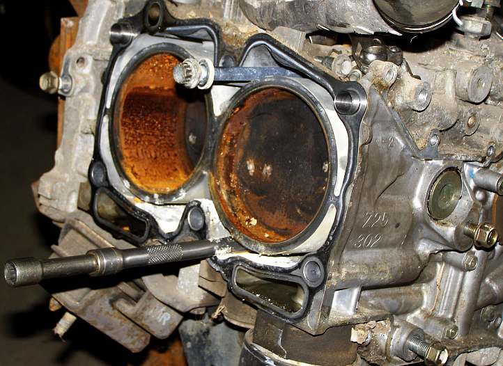

Rusty bores. With the heads off to reveal the state of the bores, I soon learned how the crankcase halves were bolted together, including the bolts with their heads in the bottom of the water jacket! They’re in the process of being removed here.
…but it was also a steep learning curve for me as I found out how these engines were put together. There was the arrangement by which the piston pins had to come out, with portals at each end of the block(s) that needed to be uncovered. When one pin was lined up for removal a pair of long-nose pliers was used to remove the circlip. Then a rod was pushed through from the other end, which was clear as the rod angle at that point got it out of the way, to poke the pins out the end of the block.

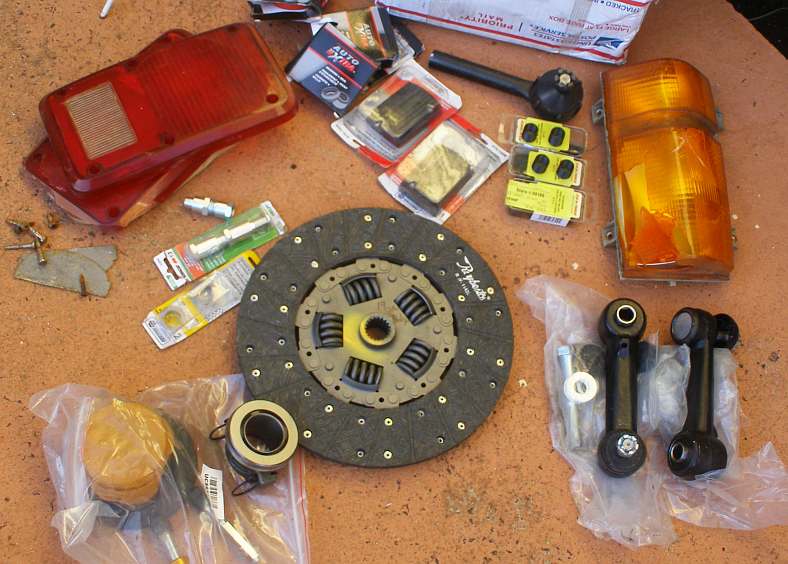

Through this period I’d been waiting patiently for some more things to come from America. They’d been sent in two flat-rate boxes through USPS and tracking showed they took a little time to get from Kentucky to Chicago but they sat there for a long time. Eventually one parcel arrived…
Damaged goods. The first box arrived with the clutch plate and throwout, part of the drag link, spark plug inserts, pedal rubbers, idler arms, a Chevy concentric clutch slave cylinder and throwout bearing, some seals and the damaged lenses.
…and I was far from delighted with the state of the tail light and parking light lenses, which had been damaged in transit.
These parcels originated with the fact that I’d been sent the wrong clutch plate and throwout bearing, so I figured that I should take advantage of the shipping arrangement to get other things, one of which included a drag link which wouldn’t fit in the box. I understood that the one I ordered had screw-in ends, but it was a one-piece unit and so I had it cut down for shipping.

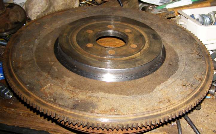

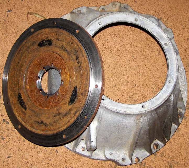

The Hemi 6 came with a modified version of the Borg-Warner 35 automatic transmission and it sported a separate torque converter housing. This housing is a bit over an inch shallower than the regular Chrysler manual bellhousing, that meant I could get a casting done to use as a sandwich plate between that housing and the A833. Now I was making the drilling jigs for those castings.
Truck flywheel. A stepped flywheel from a 318 truck engine provided me with something large enough I could use as a face plate when the time comes to put castings on the lathe for machining.
Old flywheel repurposed. This is a Mopar flywheel of some kind, sent to me ‘in error’ by someone I bought other gear from when I was importing a lot of A833s and associated parts. I machined it so it would locate in the step in the back of the housing to enable me to accurately drill the bolt pattern which, in turn, would be transferred to the sandwich plate once machined.
Of course, this kind of thing was really a means of filling in my time at the Men’s Shed. Learning more as I went, eventually I would gain a lot of skills there. But as the time went on it became more difficult to see the path ahead of me for the work I’d been doing, and after six months of my income being government subsidised, that subsidy was reduced. Ahead was the prospect that it would end.

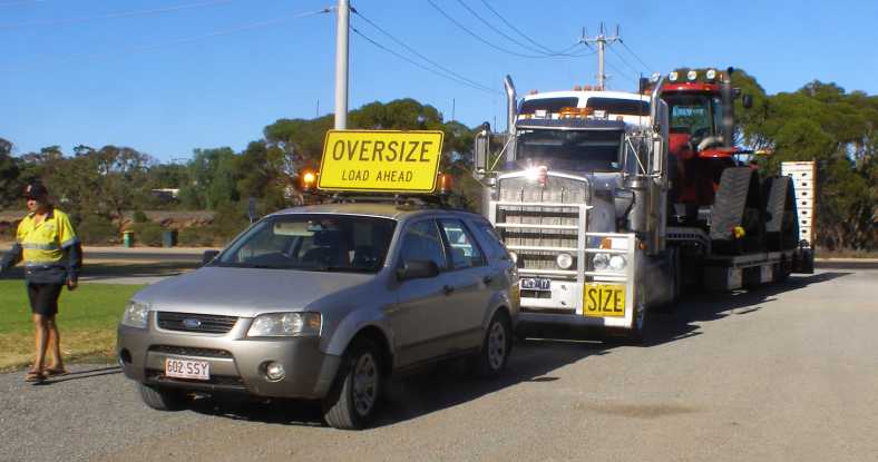

And then I had to prepare a vehicle for the job. That would be the Territory. But in the meantime the second of the two parcels from America had arrived:

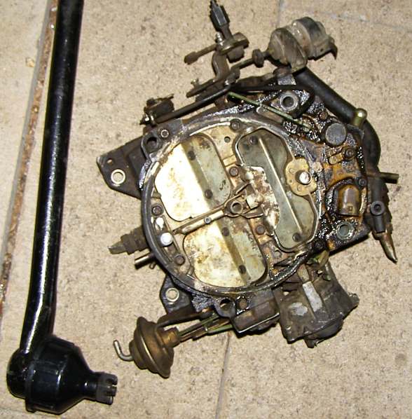

Another Quadrajet. My spare engine for the B350 didn’t have a carburettor, so getting another Quadrajet while I was shipping stuff wasn’t a bad idea. The other end of that drag link came in this parcel too.

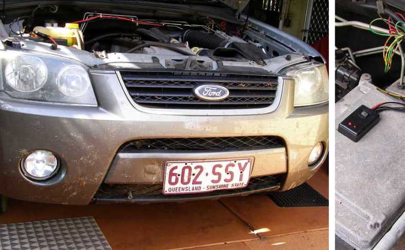

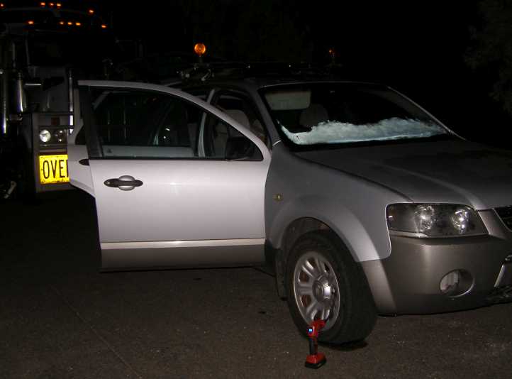

By the beginning of November I was working on the Territory project. The first thing was I had to fit fog lights to serve as wig-wag lights, necessary when escorting a load more than 15’ wide…

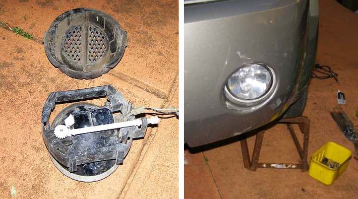

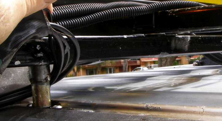

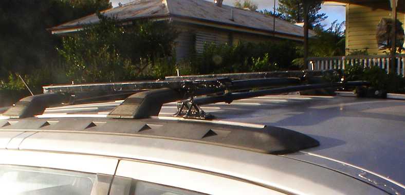

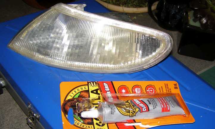

Fog lights. Further reason to be unhappy with the Territory. Fog lights clip into mouldings in the back of the plastic bumper bar. The little grille is the ‘hole filler’ for cars without the fog lights.

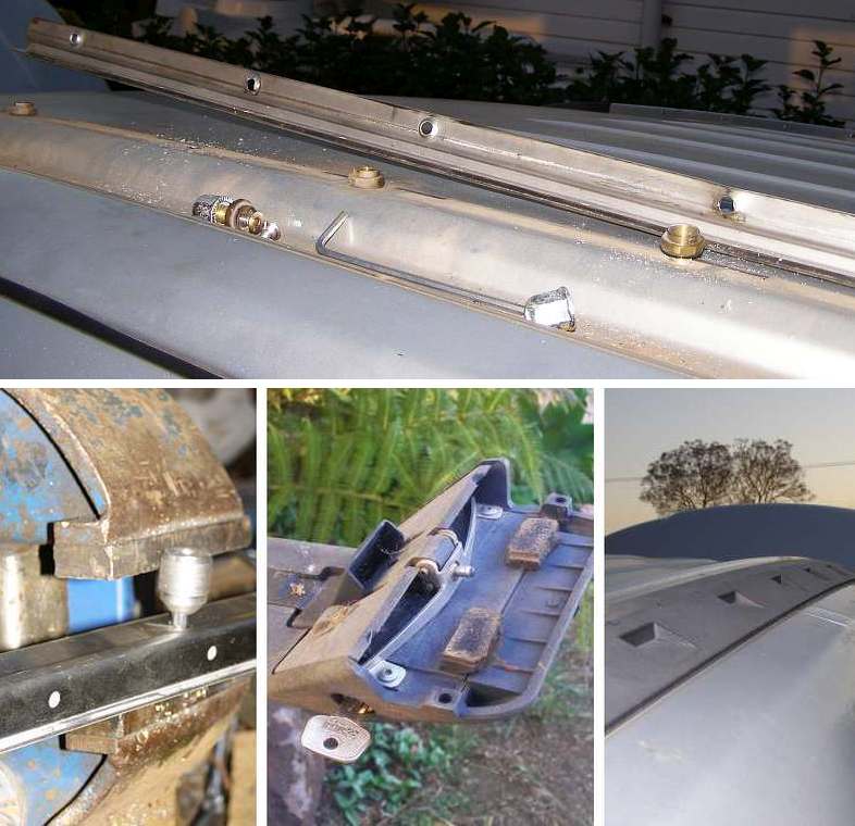

I purchased a frame owned by Dennis which was fitted with the roof sign and rotating beacons as well as the two aerials for UHF radios required for this work. I thought, “This will be easy, just clamp that onto the bars across the roof!”
Then I looked closely at the situation. The bars clip into stainless steel rails running along each side of the roof, I looked even more closely and found there were just five 6mm countersunk stainless steel screws along each side of the roof holding these down.
The rooftop dilemma. I quickly decided that five screws wouldn’t be enough, so I went back to the wrecking yard and got more of the brass bolts that anchor the screws. But I had to make up a device for dimpling the rail once I’d drilled it. And then I found that a little 5mm pin mounted in plastic held the bars into the rails. But, with the plastic trim it all looked so solid and neat!
The process of working through this wasn’t endearing me to the Ford design staff. I was thinking about me driving along with the big sign fixed to the bars, then having that withstand the force of wind of an oncoming pantechnicon doing 60mph! My next step, then, was to make a better, stronger bar with more fixings to take that load.

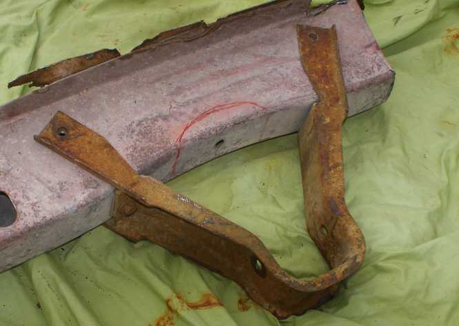

Sample piece. The plan was to use these to allow me to fabricate the new larger-and-wider mount for the rear of the NV4500 gearbox. As this fabrication would all take place at home, about 90 miles away from where the van was, a piece of the crossmember was to be very handy to have on hand.
Note the red line on the ‘sample’ as well – this was a piece which would have to be cut from the crossmember in the van to allow clearance over the larger rear section of the 5-speed gearbox. So the pieces I had to work with would also give me all the help I needed in fabricating braces to go inside the van’s crossmember to replace the strength to be cut out of the lower part.

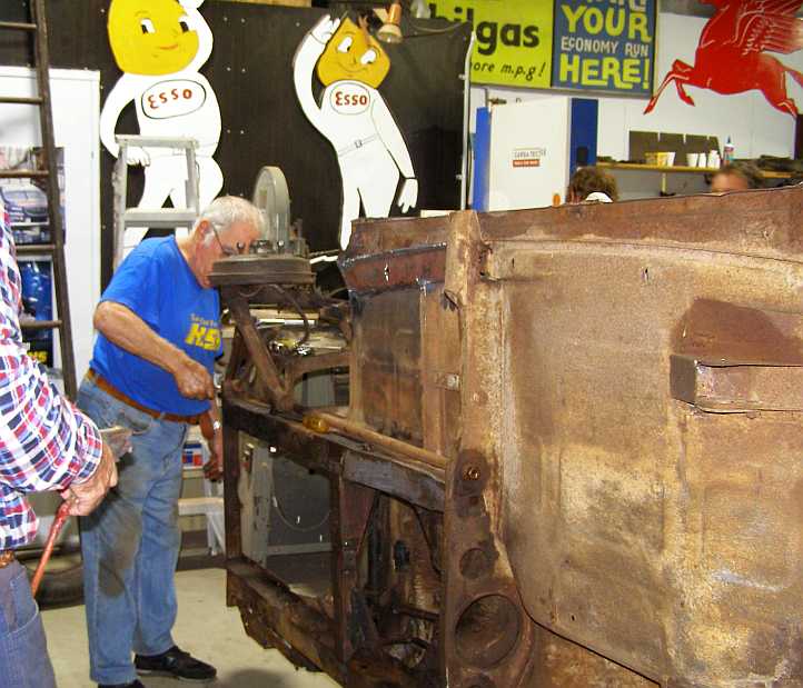

One of these people was Jim Scott. He’d taken advantage of the relaxation of the Covid travel rules to run down to Victoria with his car trailer and retrieve the remains of a Jowett Jupiter. Jowett was a British brand and their Jupiter sports model used the underpinnings of the 1500cc Javelin sedan.

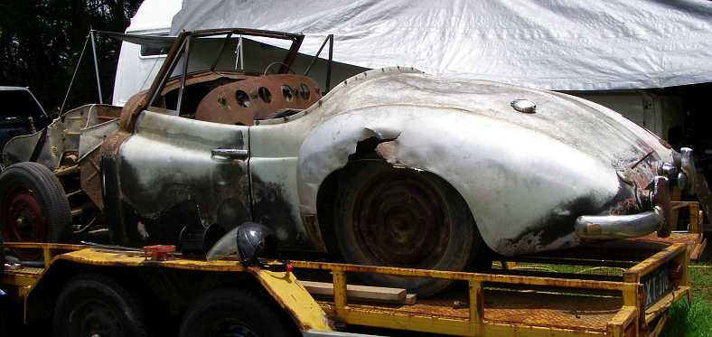

Jupiter remains. Jim’s Jupiter arrived from Victoria looking like this. The rocker covers and front of the flat-four engine can be seen, also the alloy block sections and the cast iron cylinder heads.
This car had been on a property where a severe grass fire went through, hence there was a lot of damage to the aluminium body panels as well as other components, tyres and so on. Jim took wheels with usable tyres down to bolt on for the trip.
Fire damage. Fires don’t leave alloy body panels in good shape when they pass through, and while the photo also shows the basic sporting lines of the car, it also shows how it’s suffered through the flames.
Seats and wiring also sustained damage, instruments and cables as well. Jim’s optimism in taking on this project reflects a long-held desire to own a Jupiter to garage alongside his very nicely restored Javelin. But the work to be done will make a huge joblist:

Two things were bugging me about preparing the Ford Territory for the escorting work...
The first one was the fragility of the mounts on the roof of the vehicle, the second was the wiring required to make all the bits I’d bought from Dennis Barber work out. The wiring loom with it, I finally determined, had to be set aside and I’d work it out for myself.
But, down to brass tacks… or actually brass bolts, having had a couple snap off when reassembling after preparing things so there’d be an extra two bolts on each side of the roof, I had to find an engineering solution.
The problem is easily seen in this photo:
Ford’s brass bolts. Inverted for the purpose of the photo, the complete bolt to the right shows how it’s got a blind bottom to it to prevent water leakage into the car. Next to it is one which has broken, the 6mm thread inside a 10mm thread not leaving much metal to hold when the nut’s done up.
The inverted taper in the head of the bolt is for the countersunk screws – and the dimpled stainless steel rail – to seat. My plan was to fit longer screws down inside the bolt which would give it some strength when the nut from below was done up. This necessitated drilling and tapping further down into the bolts…
Drilling and tapping. Setting the bolts up in a piece of tube, I drilled the hole deeper three at a time and then tapped them so 10mm longer screws would go in there.
…but taking care not to go through the bottom. The drill was marked for the depth and the stop on the machine was set. The job went smoothly and I was a lot happier with the arrangement.

Another Dodge component takes the wiring to the items the switches control:
Connectors. Getting the power out of the case fell to the Dodge firewall connectors, while pieces of aluminium plate were hand-cut to brace the holes and retain the components.
This was all a lot of work. The hole on this end is seen in the previous picture as the point at which the three pairs of high-load main cables enter the case. The Anderson connectors can also be seen in that first picture. I used a lot of small stainless steel screws and nuts to put it all together, even bracing the hinges on the case as they’d never stand up with the case having to be open in use.

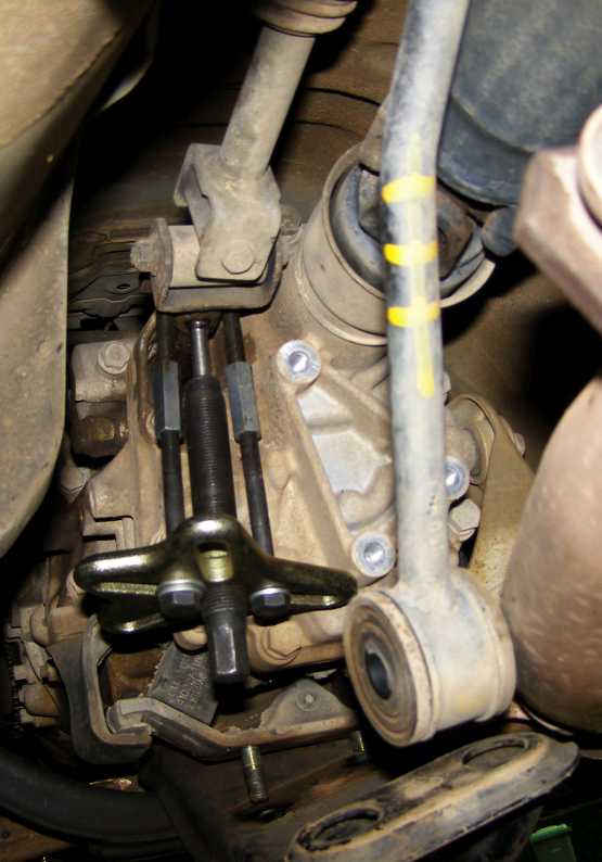

It required some innovation to get it apart…
Puller improvisation. The roll pin holding the linkage parts onto the rod into the gearbox required the use of some extra bits I made up for the puller.
A number of bits had to be unbolted to get in the right position to operate the puller. The two pressings which support the rear of the gearbox, the bracket which holds the rod which acts as a brace back to the base of the gearlever mechanism. That’s the three bolt-holes you can see on the back of the box and the rod with a heavy rubber bush hanging down, I tried at first to just drop that rod, but the bracket was still in my way.
The part I was replacing was virtually a universal joint made of tubing, bushes and so on:
Gearchange ‘universal’. The roll pin I was having to remove was substantial (see insets) and was two roll pins in one with an inner pin. The worn out bushes are clearly seen.
Some people might have tried to knock that pin out with a hammer and punch, but I figured that might be too much shock loading on the aluminium housing into which the rod in the gearbox fed. Anyway, it might have made some more work for me to set up the extra tooling for the puller, but the job got done and the gearchange is now excellent.

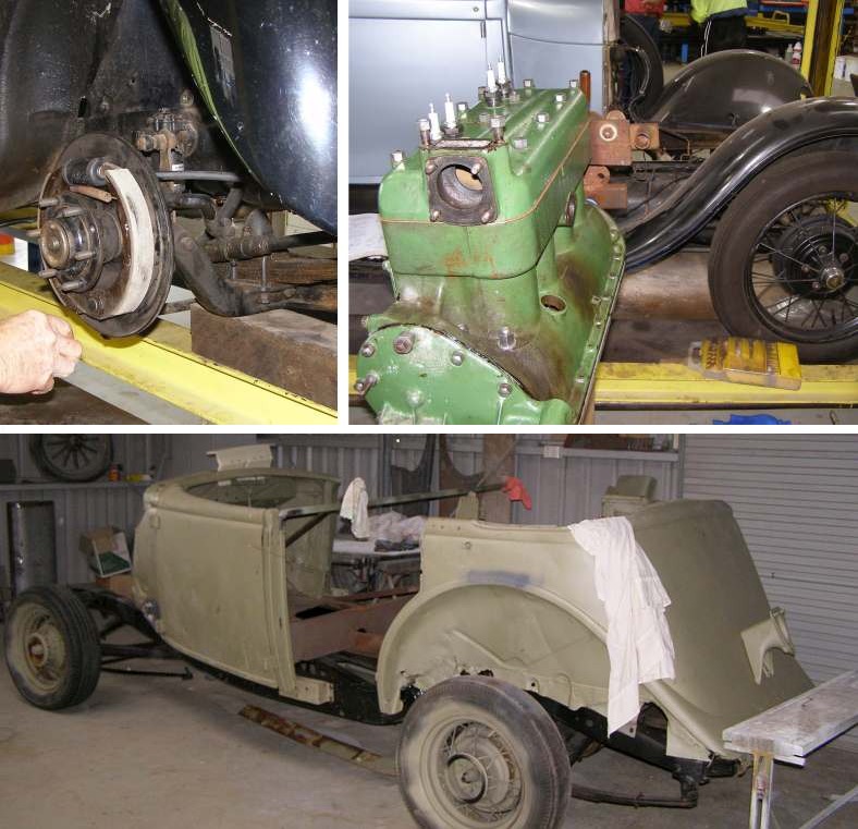

Other people were also working on their cars…
Bertone X1-9 rebuild. This was at the Car Club workshop, where the owner was housing the car while doing a comprehensive rebuild on many parts to ensure it will eventually become a reliable unit for club runs, perhaps everyday usage.
…like this Bertone X1-9. It came from a deceased estate, if I recall, and had been out of use for many years. It had however, been garaged and didn’t suffer deterioration in the body.
The Car Club’s own 1922 Hudson was coming along, too. A team of helpers work on this each Wednesday at the Club’s ‘workshop day’ and many have honed trades from engine building, aluminium panel work and fine woodworking to painting on this project.
1922 Hudson project. This car had been gifted to the Men’s Shed, but was then passed on to the Car Club as it was too big a project for the Men’s Shed. The bodywork is mostly aluminium panelling over timber frames.

Getting back to the work side of things, I still had to fit wig-wag lights to the Territory. I’d purchased a pair of foglights from a wreck locally and I worked out a way to fit some LED globes to them, now it was time to get them onto the car. I’d be needing these on jobs where we had a load wider than 4.5 metres (14’ 9”) in Queensland, but they aren’t to be used in NSW.
Wig-wag lights. The foglights simply clip into the back of the bumper and are operated via the little black box I’ve attached to the ECU box under the bonnet.
I’d laboured to find a way to get a wig-wag controller economically. Dennis had simply paid an auto electrician to do the job for him, but I went hunting and found this little controller on eBay for about $18. The lights have to flash alternately left and right. This unit give ten options for the flashing so it’s a good thing. I can even use them as straight fog lights.

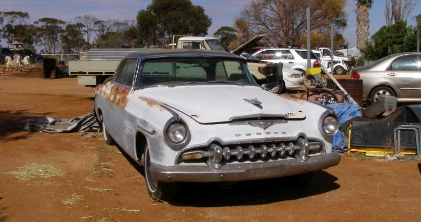

So I made the drive back home at a bit more leisurely pace. I stopped in at a large wrecking yard on the outskirts of Broken hill…
An unusual car. This model of De Soto never sold in Australia, we had a rebadged Plymouth (in a 4-door version only) 1954 Plymouth to fill the role of De Soto and also Dodge until 1957. So it was a rare find way out here in the bush.
…where it seemed the place was no longer in business and I certainly didn’t find anyone present.

At the same time I’d been getting some thumping under the floor of the Territory so that called for a replacement to the driveshaft centre bearing. I had trouble undoing the bearing retaining nut, but ultimately I was able to get the job done.
Centre bearing. Another eBay purchase, the failure of the original bearing’s rubber mount was soon overcome at home.

On the Monday I went off to the Men’s Shed and created a clutch aligning tool for the 19-spline clutch to be used on the NV4500. I made this out of a piece of rusty drag link I’d kept off one of those rusty B300 vans.
Aligning tool. It’s a neat fit inside the spline and the spigot-bush diameter is matched by the front end of the tool. At the bottom of the pic is a leftover section of the rusty link from which it was machined.

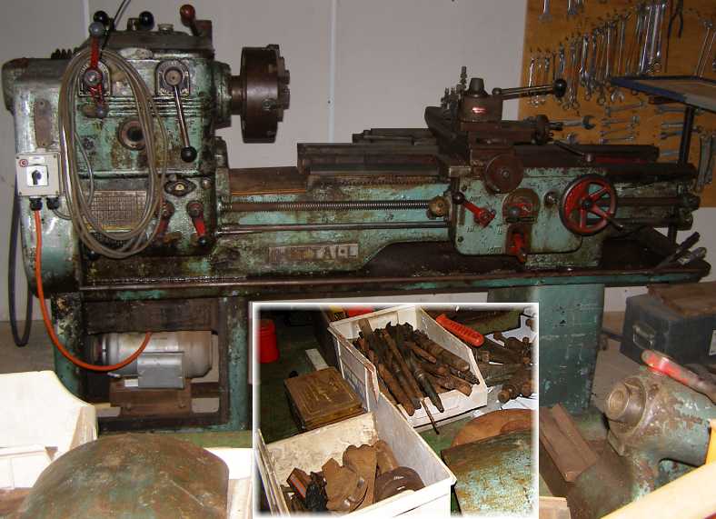

His father had been an aviation engineer and had gathered a lot of tooling for the Nuttall late, which had a longer bed than either of the lathes it would sit beside. Again, it was in need of some work, but Nicol relished the prospect of getting it right for our use.
Lathe and tools. The Nuttall lathe with some of the tooling inset. Among these are some large drills and some knurling tools, while elsewhere lots of more conventional tools and tips were crammed into a cupboard.
So all of this was a big advance for the Men’s Shed and I would be able to benefit as I continued to make bits and pieces for my jobs.

Around this time I’d established that the Territory’s engine was leaking from the front main seal. It’s not a conventional harmonic balancer with bolt-holes, but a simpler construction which requires a more complicated tool to get it removed.
As usual, I looked for the tool online. But, again as usual, it was too dear for me to contemplate buying when I had the facility to make my own:
Puller in embryo. I found the pieces of steel I needed and put the gear at the Men’s Shed to work again, welding things together at home. The arms lock in under the ‘spokes’ of the balancer hub and the puller engages on the end of the crank via the piece of cap screw which slips into the end of the threaded piece.
Another job done, another bunch of dollars not spent, but I didn’t actually use it for a long time afterwards.
