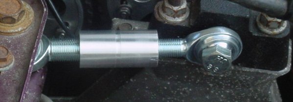

You need to adjust it out and preload the engine. I don't have a picture of the AGP one, but here is the AFX.
If you notice, the threads are made so you can adjust it to be longer or shorter. If you adjust it to be longer it puts pressure on the mount. This will reduce noise and vibration. The noise and vibration mainly comes from the a harmonic that get set up when the mount it exactly the right lenght. This allows it to "float" and causes the problem. Simply lengthen it to get it out of float, and the noise will go away or be deminished.

dogbones aren't adjustable

ORIGINAL: PSI Chick
Well that sucks. That means there is no way for him to adjust some of it out without upgrading the motor mount.
