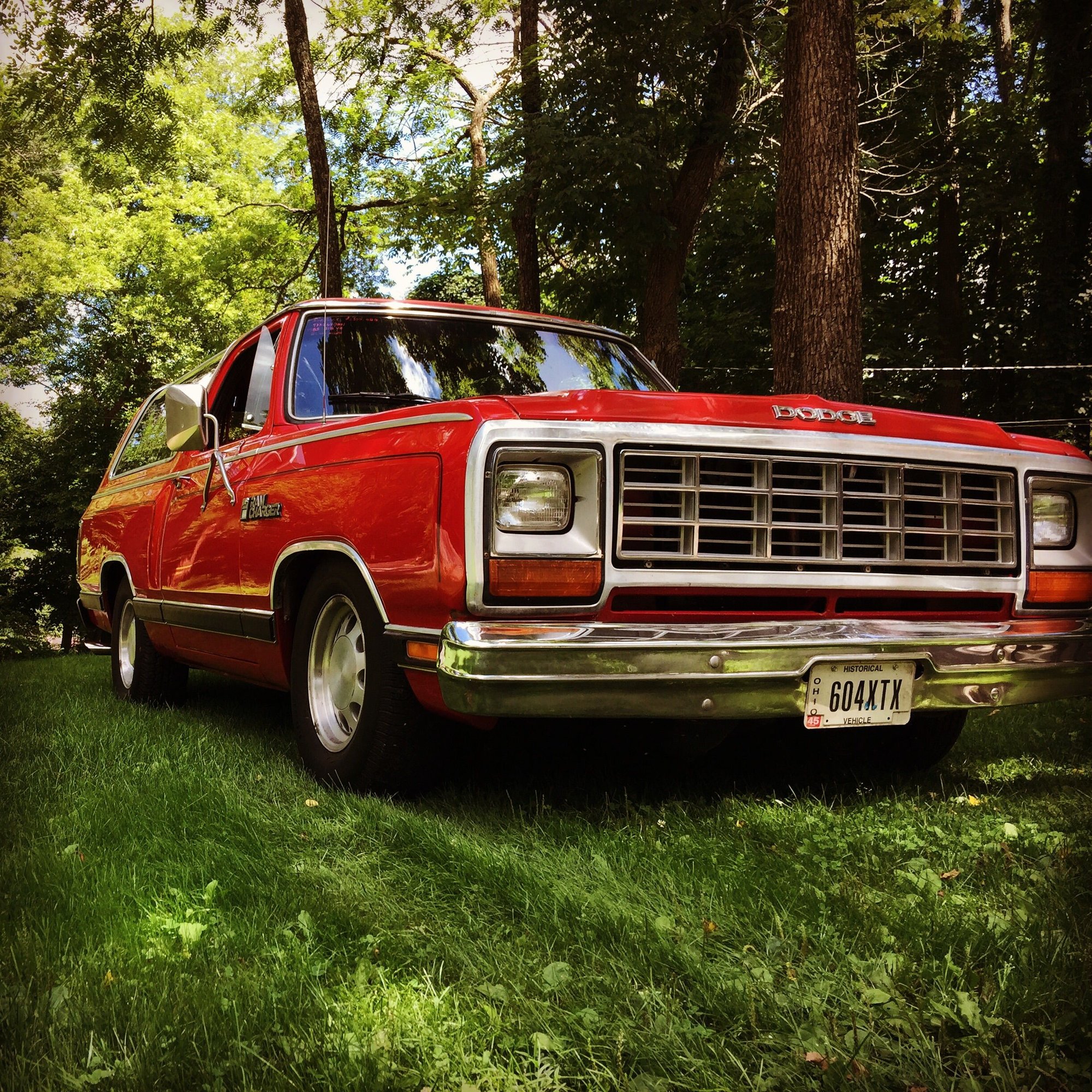

So I picked up this 85 this weekend for my son. I like it lowered but my son would like to raise it back up. Anyone have experience with this? I am thinking springs and shocks on the front, and flip the axle back under the leaf springs on the back. Any of you ever done this? Thanks

ok I just found an 89 4x4 with a crap body but the frame looks good. Does anyone know of any issues like bolt alignment and such that may cause problems if I swap the bodies on these two?
'74 - '81 1st Gen. all match up. '82 - '93 2nd Gens all match up.
'85 body to '89 frame will work just fine.
Great dude, I am supposed to pick up the 89 next weekend. Thanks for the valuable advice.
