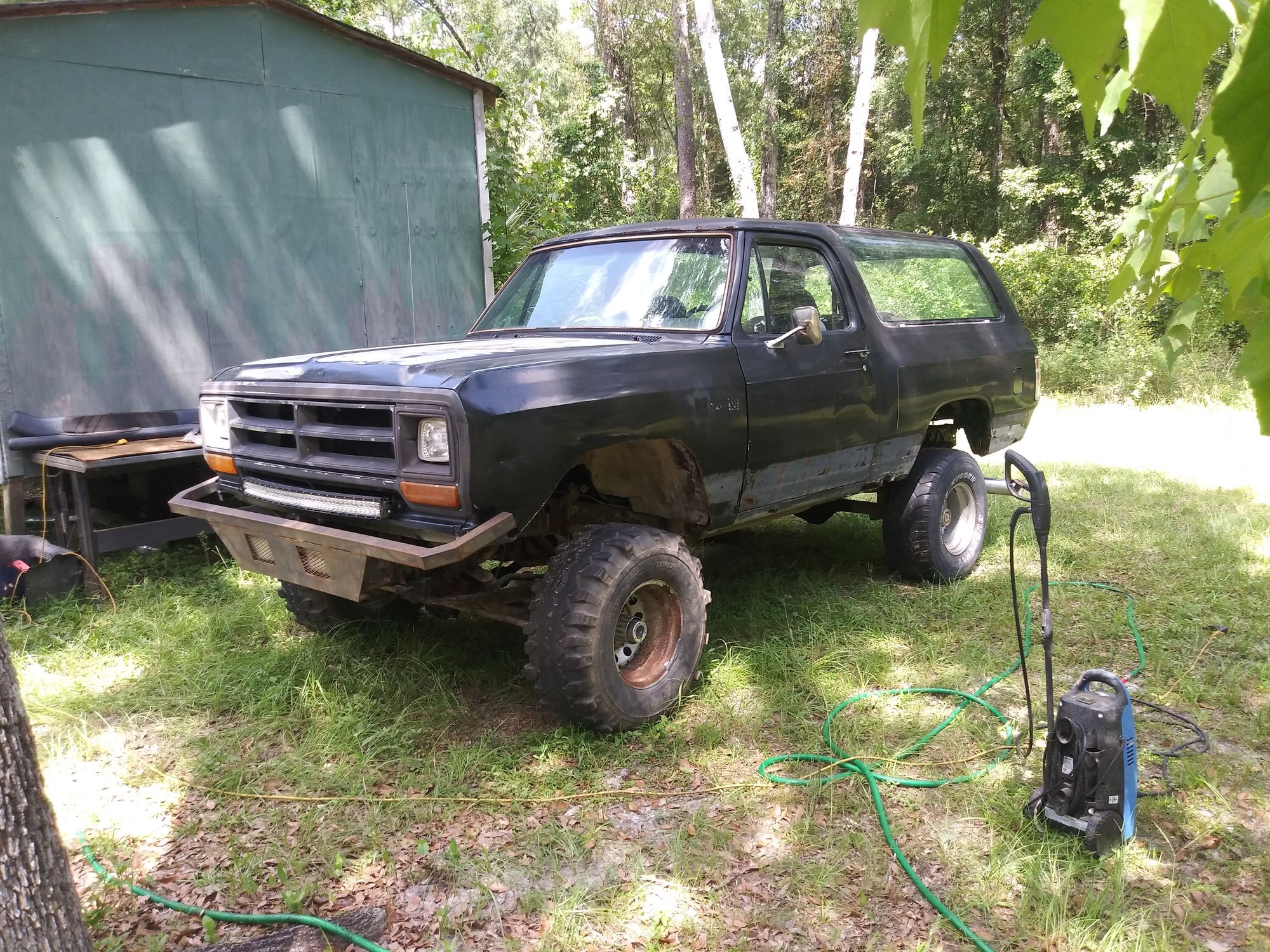

Hey everyone how's it goin got a quick question for ya I got my 88 ramcharger has a 318 that I converted to carb has a 4brrl edelbrock carb with a low rise dual plain intake has long tube headers with 373 gears it 4wd has 33 1250 15 tires I put a sum 6900 cam in her and it's a good cam but I'm wanting more lope anyone know of a good cam for off roading with some lope to it I have heard the sum 6901 cam but I don't want to buy it and not like the results thanks in advanced.
