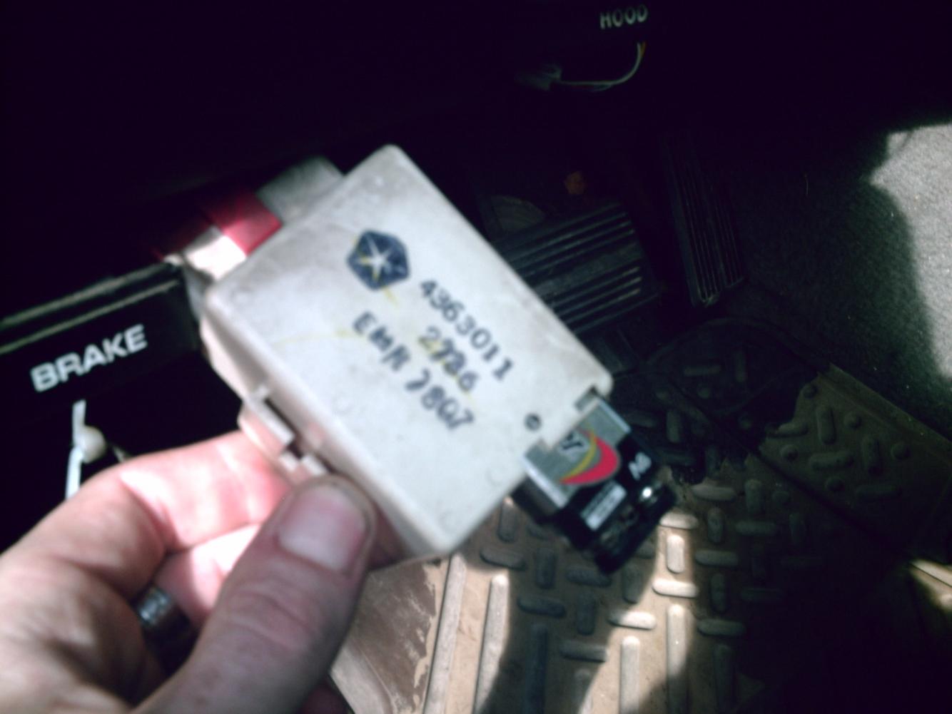

My '87 dakota 3.9l has had reliablilty, starting issues, stalling issues, and ive been through tons of new parts, ended up with entirely new dist, wires, plugs, new carb. previous owner had same trouble for years, I took the dash apart to fix speedo, and found my module with a small black door on the end, instictively i took the door off and to my surprise there was a 9volt battery dead as can be, replaced the battery and it runs amazing, guessing the battery has to do with some sort of memory so the module doesnt run in "limp mode".
That is the first time I have heard of that. Post op some pics, I'm sure it will help others with an 87 Dakota.

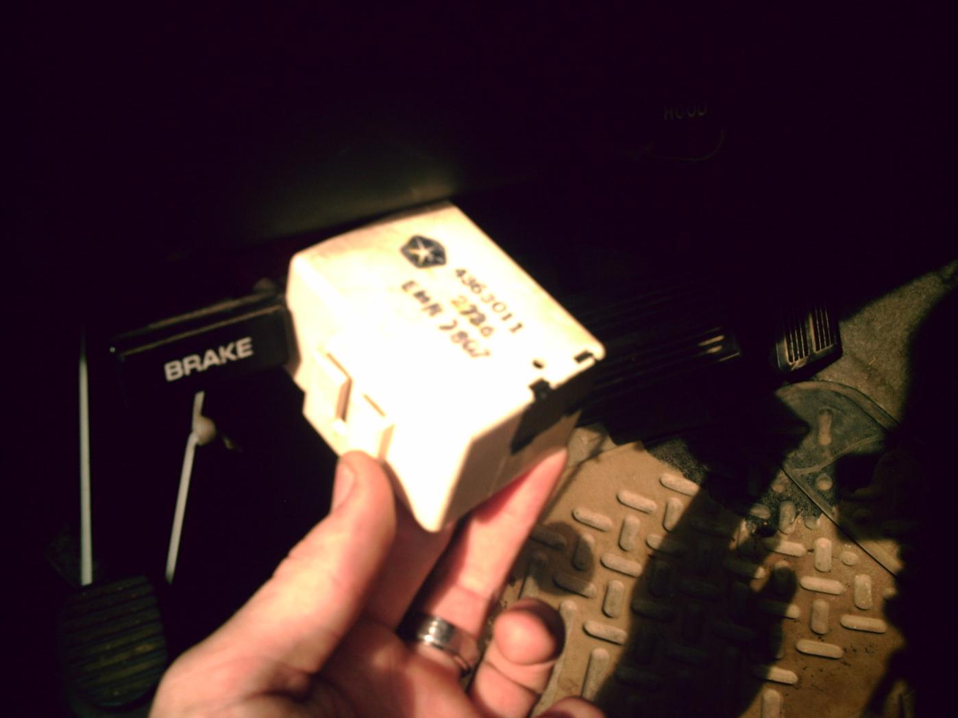

Default Hidden 9 Volt
This was the demon that possessed my truck for so many years.
Attached Thumbnails Dakota Stalling.-phto0001.jpg   Dakota Stalling.-phto0003.jpg
