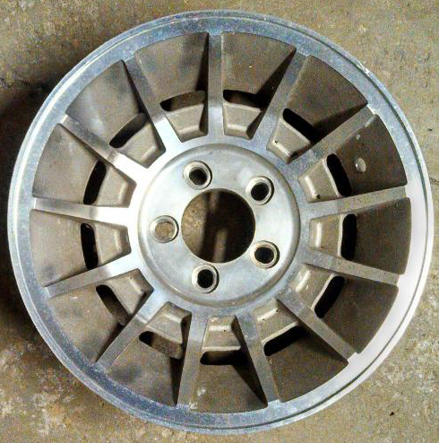

Instead I bought these which are all 15x7 (the red set were 15x8.5 & 15x10) I'm having them painted just like the red ones only black, then shipped to me:

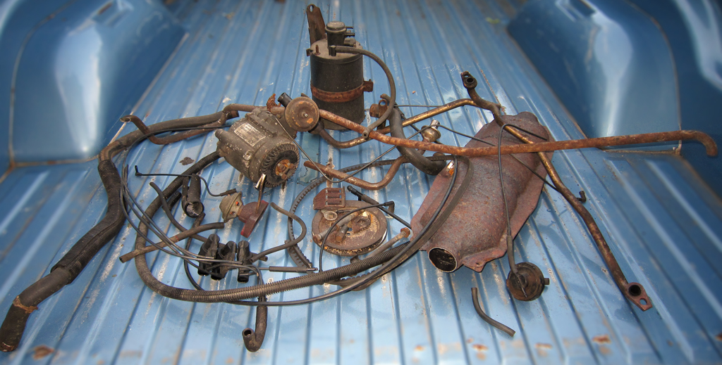

Talking Emissions Removal
Since I only need to pass safety I removed all my emission systems; removed the catalytic converter, air pump and belt (which was very loud) along with the tubing, I removed the EGR and transducer, the vapor canister, all vacuum related tubes and all the vac solenoids:
There was a total of 28lbs of junk according to my trusty bathroom scale:

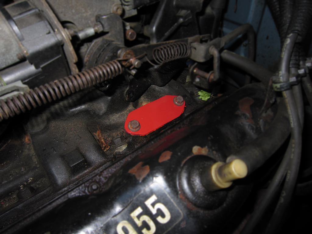

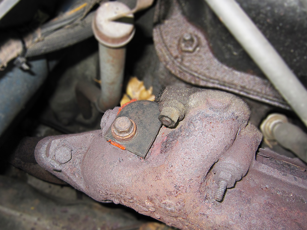

I made small block-off plates for the EGR ports on the headers:

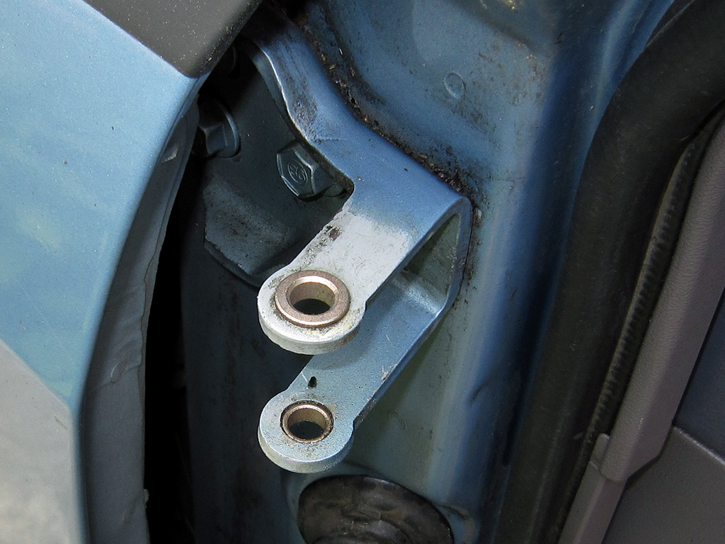

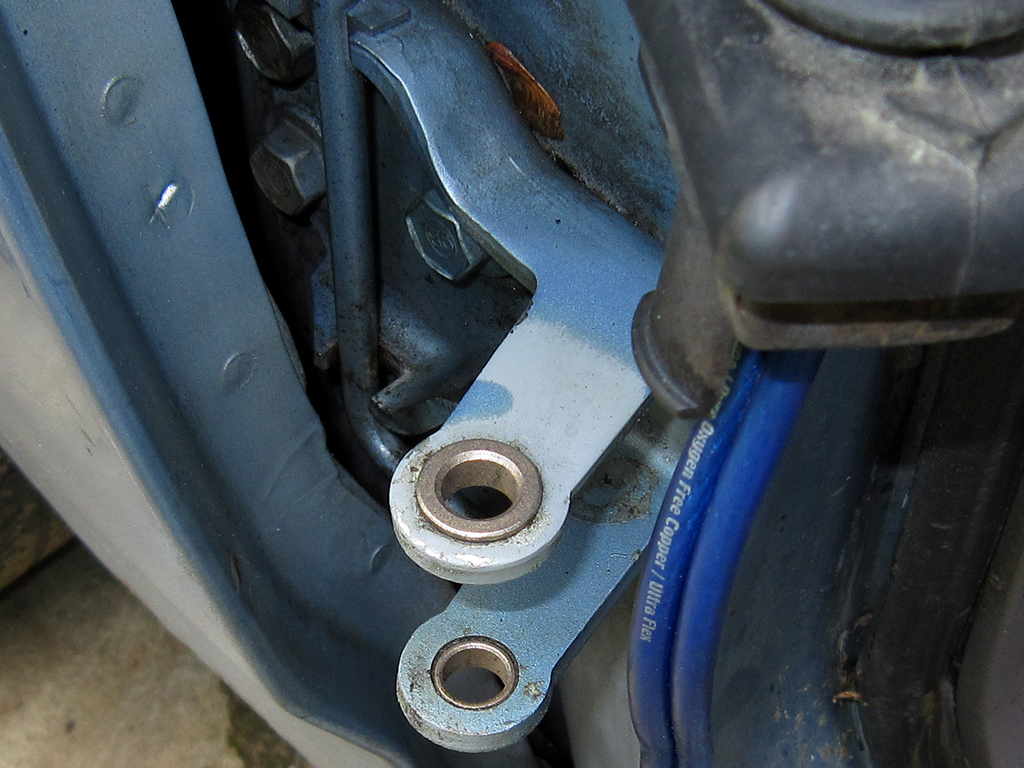

I did the hinge pins and bushings today:

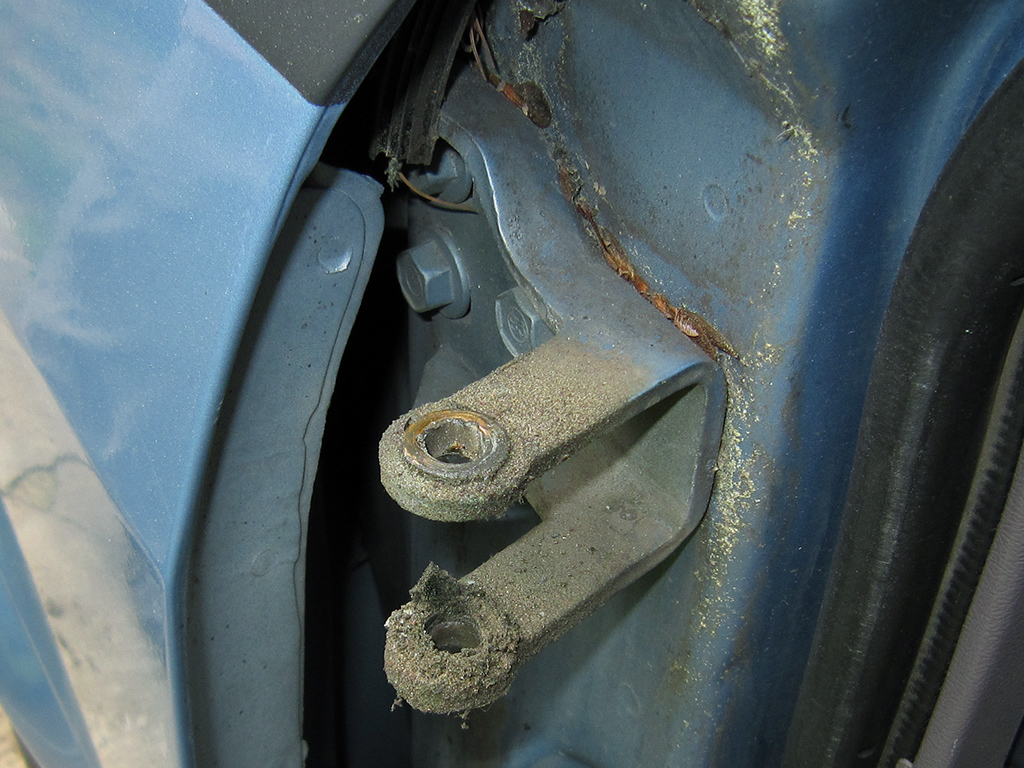

The hinges were pretty nasty and the washer-top on the sleeve/shims were getting thin:
I cleaned them up and installed the new bushings...not sure how they got so grimy?

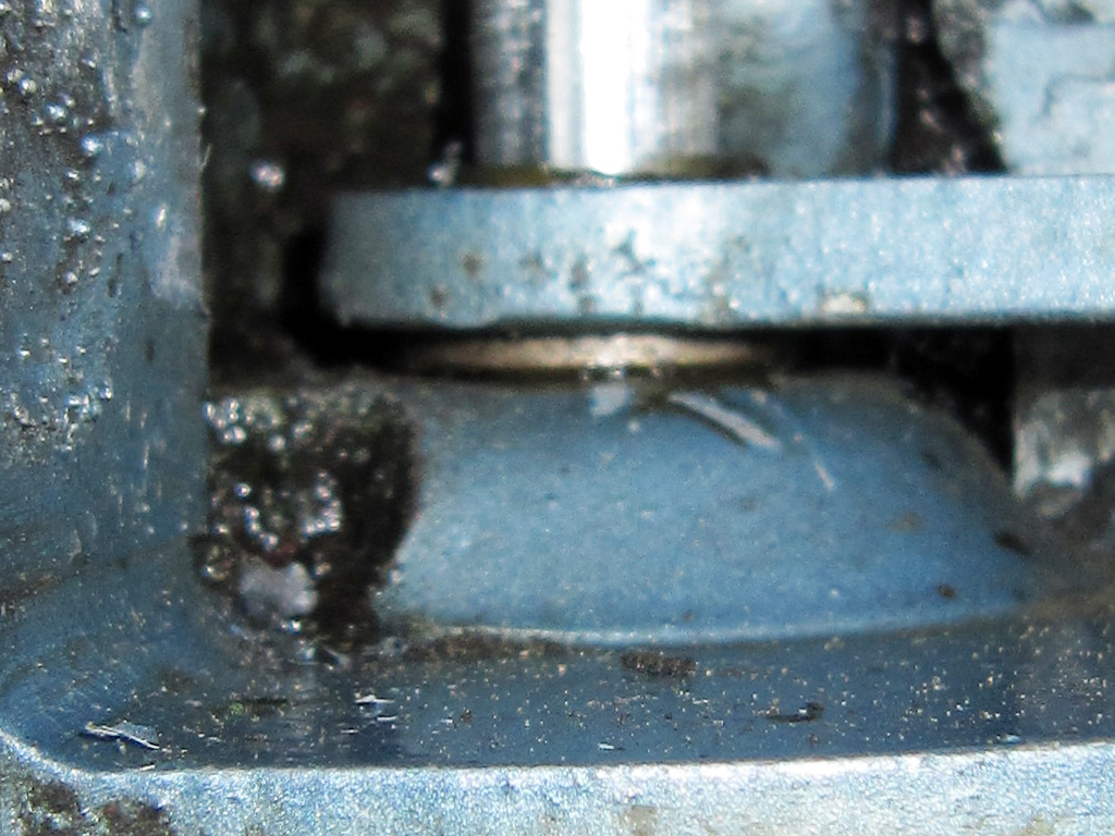

Only thing is the top single does not seem tight enough see how you can see the pin between the door hinge and cab hinge on the bottom? The brass should be touching the bottom of the door hinge:
See the bottom door hinge touches snug to the cab hinge and the brass is touching:

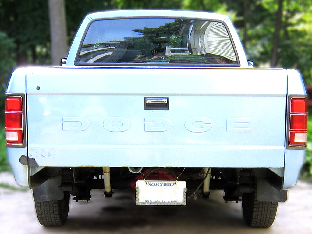

Dropped the bumper, I think even nothing looks cleaner than a stock bumper until I get a pan:
About 10min and some Rustoleum rust converter and I think it looks a lot better on the eye...probably won't last a month into the winter but it was just way too much visible rust without the bumper. I also got rid of the useless spare tire and it's mount system, along with shamefully painting my 7.25" red:

In other news, I wonder how hard it would be to just get a piece of sheet aluminum or stainless steel (or just sheetmetal) to cover the gap for now. Tack it to either side and call it a day, or paint it black or blue to continue your color theme. Bet it wouldn't be more than $30...
Old Jun 23, 2013 | 09:14 AM
  #120
pinkfloydeffect's Avatar
pinkfloydeffect
Joined: Jun 2011
Posts: 858
From: Pinellas County, FL
Yeah I was thinking about welding a flat wide piece of bar stock to the stub rails on the bumper.
