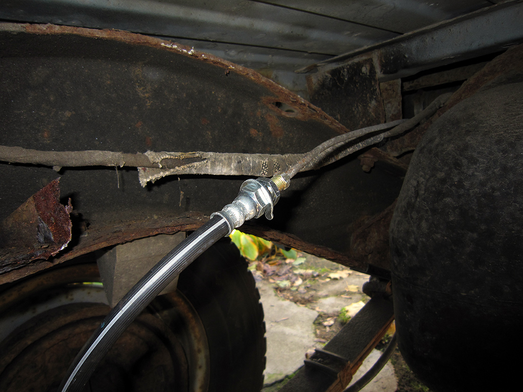

So I had the neighbors daughter pump the brakes while I bled them and she does not drive yet and pushed way too hard...blew the rear flex line so I had to replace that now too. The mount has completely rusted away and I am not putting much work into this POS chassis so I will have to figure something out...maybe zip ties?

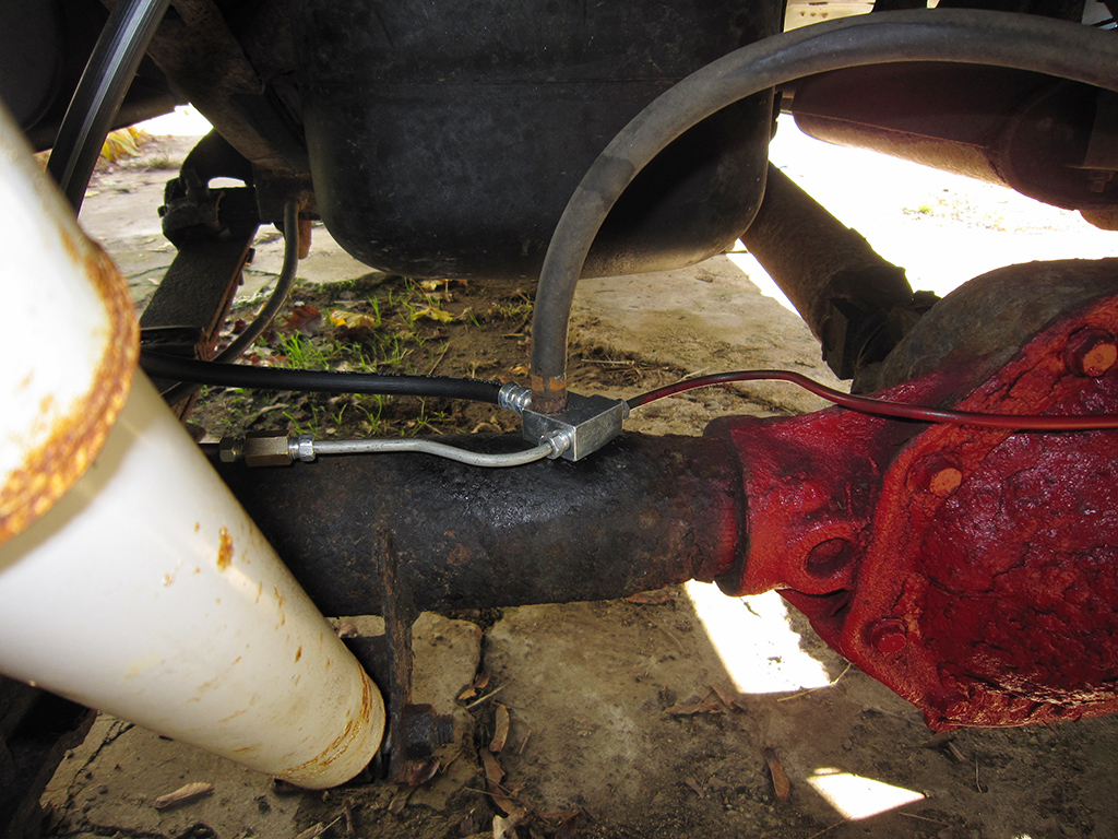

I painted the 7.25 red as a joke....anyway the red line to the passenger wheel is only a year old because it went on me. I ran out of line so I had to splice two together for the drivers side but nothing has to look good under this truck I assume it's still safe? There are no leaks....

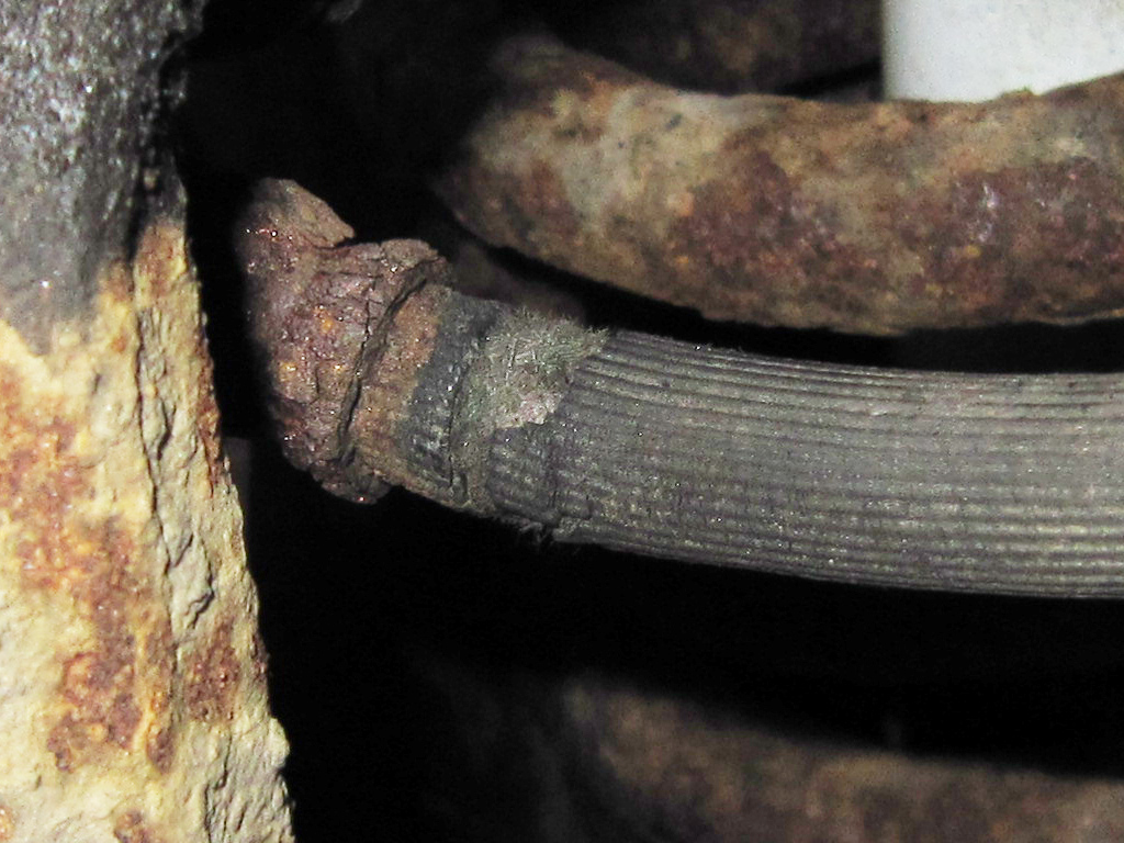

Finally with rear holding pressure again I went to make sure I can free the front bleeders and they are frozen, so now I had to replace the flucking calipers too! Good thing because it made me pay attention to the front flex hoses...
Yup both the front flex hoses needed to be replaced too I am so lucky they have been holding but I believe even though I was not really loosing fluid they were probably sucking in air!

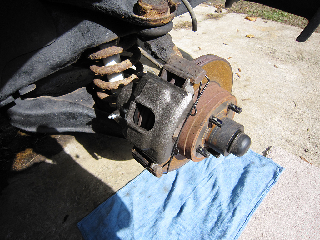

I should do my ball joints and tie rod ends soon too, good thing is the new rotors I put on (over-sized) 2 years ago/6k and the over-sized pads are barley worn I hope they were not the hard lifetime warranty pads. I am still waiting on some front flex hoses but did I put the spring steel wire loop on correctly? I have the long side OVER the mount insert pegs so the long side bends to the curve of the rotor...or does it go under the mount insert pegs and stay straight??
