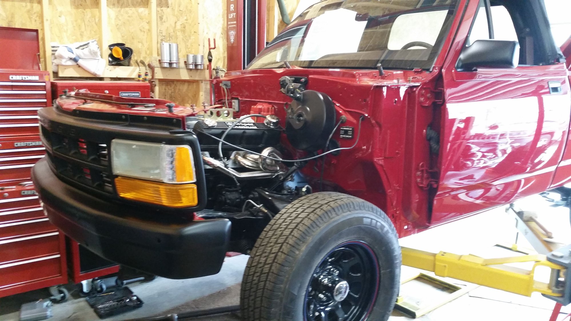

It's never easy....So I discovered with my front end swap of a '94 to the '90, the bumper mount holes on the frame aren't in the same place. The bumper mounts on the 87 to 90 are more rectangular and shallower, and the mounting holes are fixed in an equilateral (or at least isosceles) triangle. The mounts for 91 on up, are angled, and the holes, while on an adjustable plate, form a scalene triangle, and they aren't parallel to the ground in orientation like the 90 mounts.
Comparing it to my 95, it appears the front hole is the only one in a common location. So I made a template from the mounts and commenced drilling new holes into the 90 frame. For now, I just drilled one more hole in each to mock it all up. Looks pretty good. The gap between the grill and bumper is maybe a 1/8" wider than on my 95, but that's because the front hole is a little lower on the 90 frame than the 95. But not enough room to move that one.
Anyway, here's a picture of the freshly painted truck, bumper, grill and headlight doors. I went with a nice satin black for the grill stuff. I think it looks pretty good.

Front fenders on and engine plumbed mostly. Need to install the regulator and fuel lines and a couple of brake fittings...coming together slowly but surely. Lots of little odds and ends and then wiring the engine bay.
