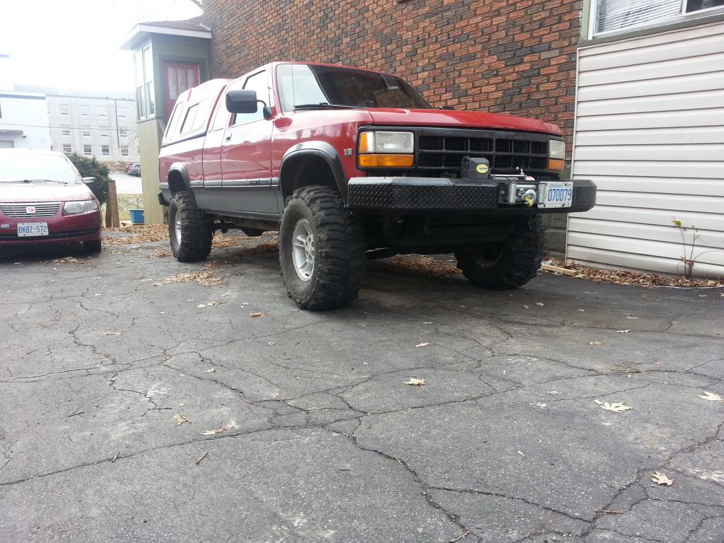

steel it is .. I built my winch bumper.. T-Boned a 2011 Impala and well lets say I wrote that car off, I drove away needed some more tremclad :O LOL for the bumper
racers? LOL gawd
so u can see mine:

Thats what I am going for. Beautiful truck you have there.
