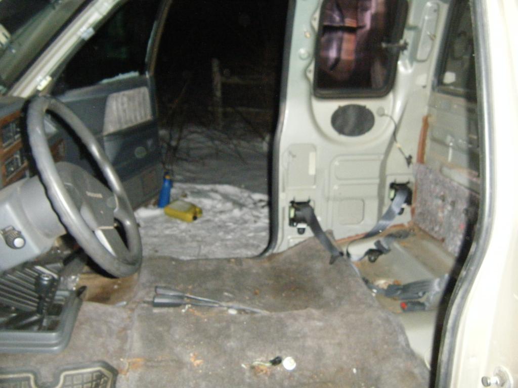

Today, 1/26/14, I got the bed off and stripped out part of the cab interior.
It was a little chilly out.
The worst rot is behind the front leaf spring hanger. I am convinced that if the hanger rivets weren't there, the frame would break in half.

The cab was lifted off using a tree branch and a system of ratchet straps and a wood frame constructed inside the cab. I'm going to need to figure out something else to put the cab back on, because it was impossible to pull the cab off level using this method.
