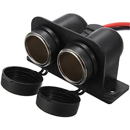

I bought a new harness and installation kit, only cost me an extra $12.00 total. Since the stereo already in it is aftermarket is has an updated harness, but this way I am starting from scratch, I can solder the conections and then pull the dash and put the new stereo in and the double Cigarette Lighter Socket that I am going to place under the dash towards the passenger side, to run vacuum cleaners, coolers and such.

I have a pigtail I added to the current cig lighter for when I put a pair of outlets on the passenger side, in the trim between the cup holder and the vents (that part of the dash is empty, so perfect for anything I want to put there.)
