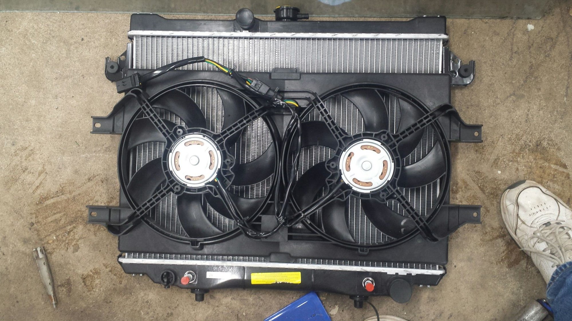

A few years back, I purchased an intrepid fan assembly.
I had hoped to sandwich it between the condenser and the radiator. However it is too thick, and giving up AC is just not an option I want to consider....
I may end up installing it behind the radiator for now....
But latter, I really want to use 2 fans, sandwiched between, like the shelby dakota did.
I really want a 5.9 magnum in this truck!!
Not sure what your opinion is on electric fans....
I would hope it would help AC work better in stop and go traffic....
And of course with a V8 and the 87-90 front end. I dont believe there is any other option.
Here is a picture of what I have.

Any idea how much air those will move?

Not Really, On the internet, some are claiming 3,000 cfm on low.... But again, you know how accurate post can be!!
I do know, member ragged89 is using them in a way that they are not designed....
He has a 89 dakota, with a 318 magnum engine.
He mounted the fans in front of the radiator where the condenser used to set.
He is using it as a pusher setup.
From what I remember, low, even in this way mounted, is keeping his engine cool.
One other point that may be of interest....
These are 2 speed fans
You activate 1 wire, and both fans run in low.
Activate the 2nd wire, (both wires activated at same time) and this gives you high...
It does not seem to matter which wire is low....
My thoughts are to use a temp. sensor to bring on one wire, and the ac to bring on the other.
In the event the engine needs the fan and ac is calling I will have high.
Just my thoughts.....

I like the idea, but, I would expand it a bit more. One wire, temp controlled only, for low speed. Second wire, tied to the A/C relay, so fans run on high with a/c on, and ALSO tied in to a second, higher temp, temp sensor. (I don't run my a/c all the time, and sometimes, the added cooling, without the need for a/c to be running, is helpful.)
