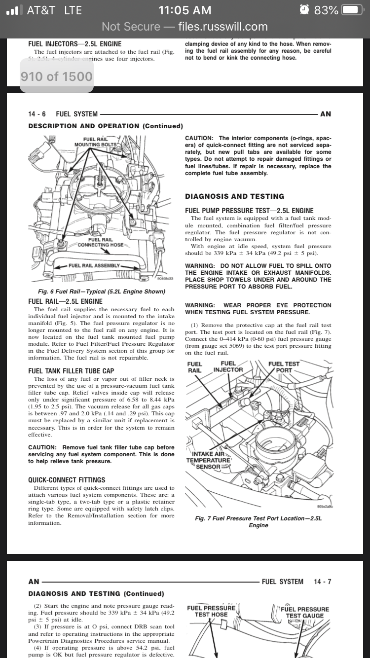

So they both are rated for around the same pressure and flow.. is there an in-line regulator on the 2.5s? Seems weird if dodge to do that.. scanning through the manual now for answers.
although the 2.5 requires 49psi

RockAuto shows the 2.5 being a return style, like you have, with a regulator at the engine. The 3.9/5.2 is a non-return, regulator in the pump.
See https://www.rockauto.com/en/catalog/...assembly,10147 .
And where are you getting 49PSI? Page 14-8 in the FSM states 14.5PSI for a 2.5, and 35-45 PSI on the 3.9/5.2 for a 1995.
But yes, that's the wrong fuel pump. Might want to try the right pump instead.
For what NAPA charged for the wrong one, you could buy a new Bosch (OEM) pump from RockAuto ...
RwP
section 14 page 4 but that was at the injectors. I don’t have a return style like the 2.5s.

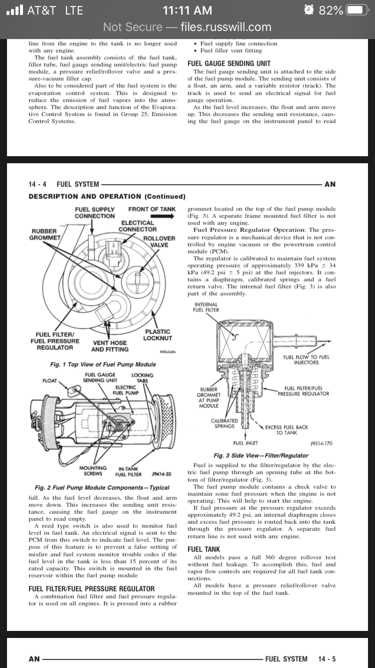

14-4 doesn't mention any pressures on the 1995 FSM (downloaded from the FAQ here). That's on page 14-6 for the 3.9/5.2, and 14-8 for the 2.5 .
The 1996 FSM shows 49.2 +- 5 PSI for all three motors for 1996.
And that was my point; the fuel pump they sold you was a 2.5 pump; regulates down to 14.5 at the throttle body for a 1995 2.5.
The 3.9/5.2 uses an integral regulator and no return line.
So now that THAT'S fixed - do your injectors now cycle?
And, BTW, you won't see the approx. 12V both sides of the injectors if they're commanded OPEN - the ECU side will be closer to 0V as it completes the circuit.
RwP

This was the page under testing fuel pressure.
I miss understood what you were saying.
injectors are operating correctly now.
I still have a lot to learn but this truck has been a lot of fun.
And this one
